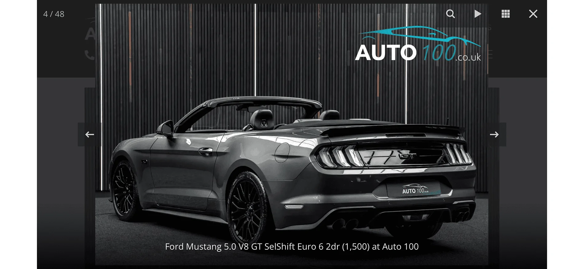

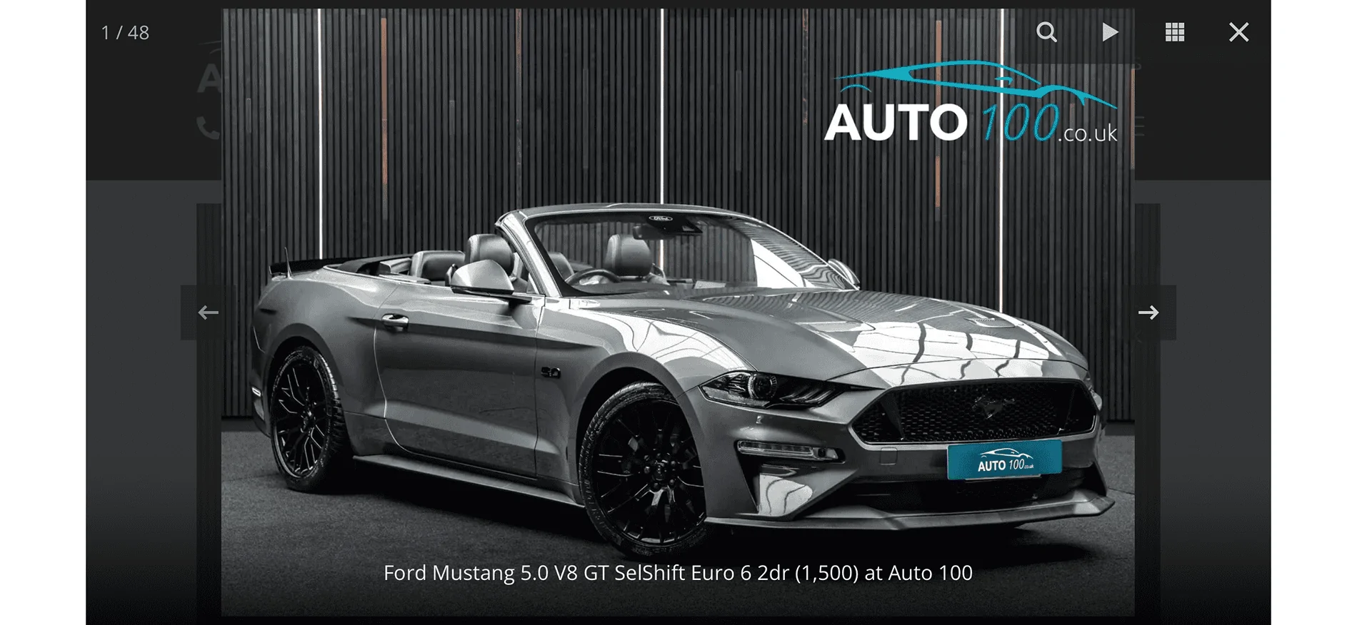

Hi all
Proud new owner in the uk of a ‘22 GT convertible auto.
I only intend to use the car for long crousing in Europe and fun blasts but no track or drag use.
I have been wondering if I even need to upgrade any IRS / subframe parts with Steeda parts.
Watching the videos it seems the stock set up leaves something to be desired and Zsteeda parts will be an improvement but what exactly would be useful for type of driving I’m intending to use the car for?
I don’t want to drop of firm up the suspension and don’t want to void any warranties.
thanks in advance!
