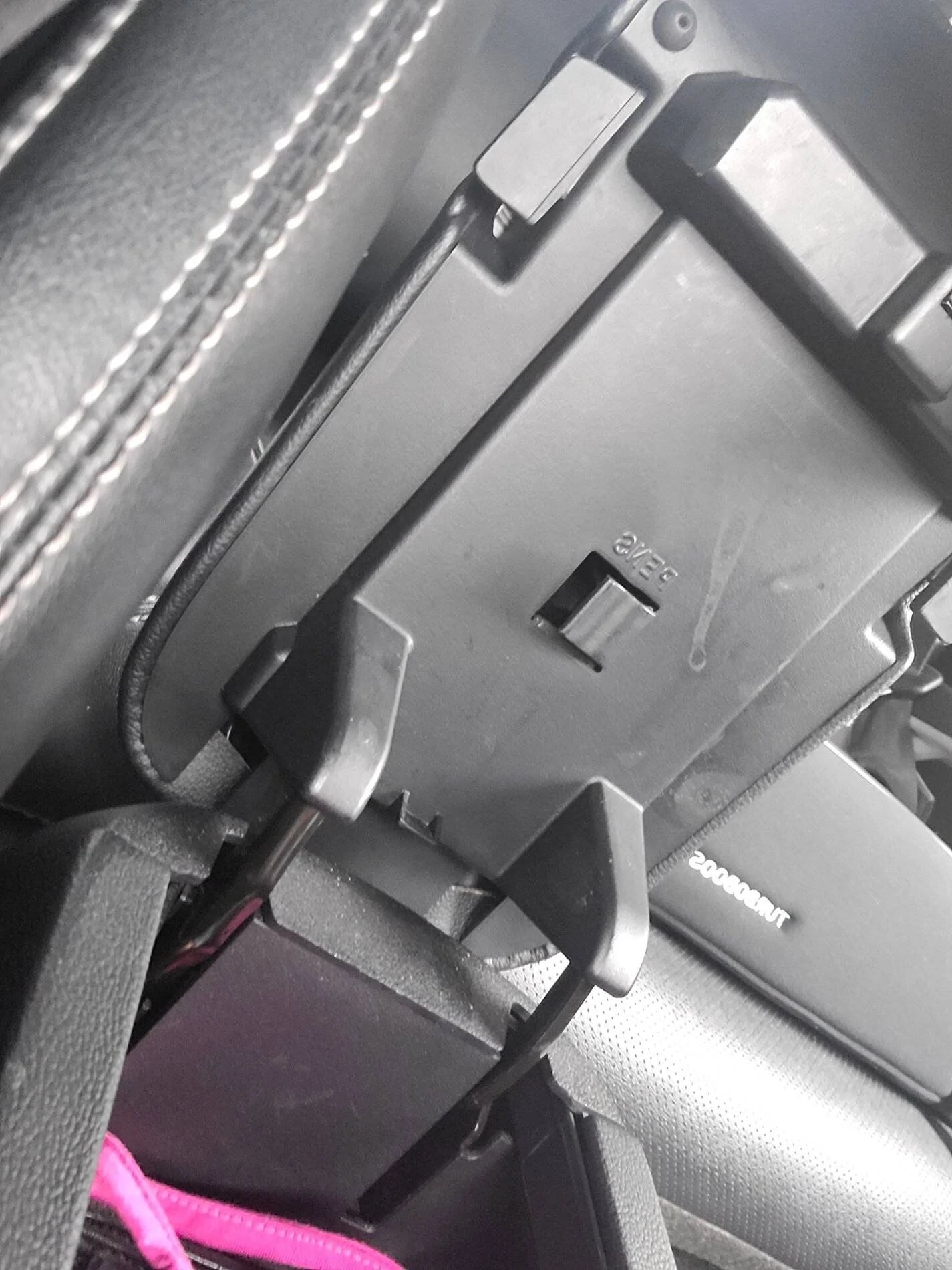

Maybe it does, never noticed those wires before lol - PS what is this clip for?
I stared at that clip in the center of the lid for a long time. Not a clue what it does. And at some point I came to the conclusion that I'm better off never knowing what it's for.
