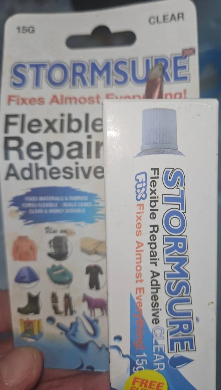

Just a word of advice. Once you open the cap and use some, put the cap back on and put the tube in the freezer. It will prevent it from drying out. When you want to use the adhesive again, let it thaw out for 15 min and you are good to go. Then refreeze it.
Also, once I put some of the adhesive on the edge of the conv top, I waited for it to fully cure. Then I used a black magic marker to cover the glue. Worked like a charm
Thank you very much.
I see on Amazon that Stormsure is available in black, at least through the Canadian site.
