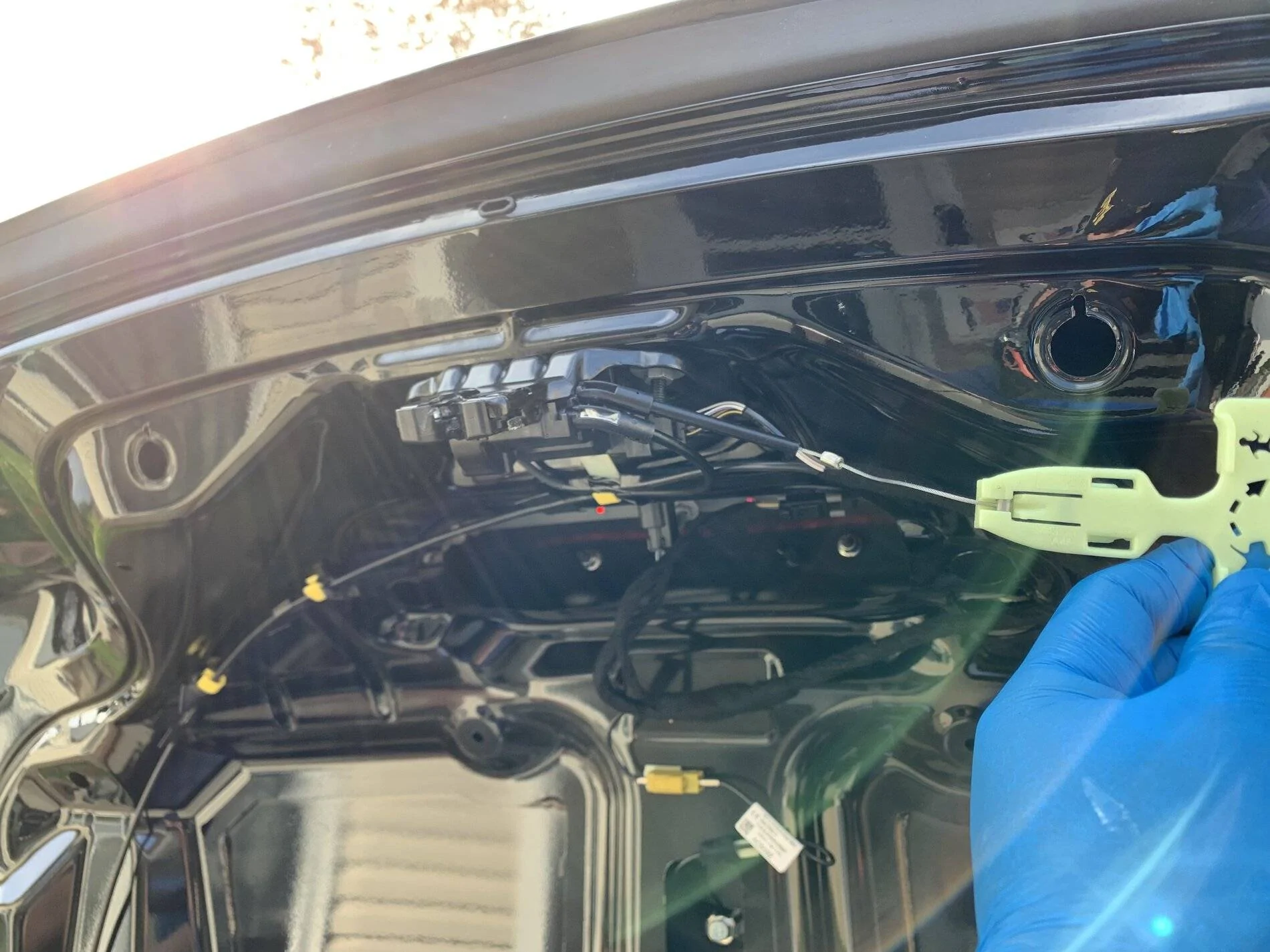

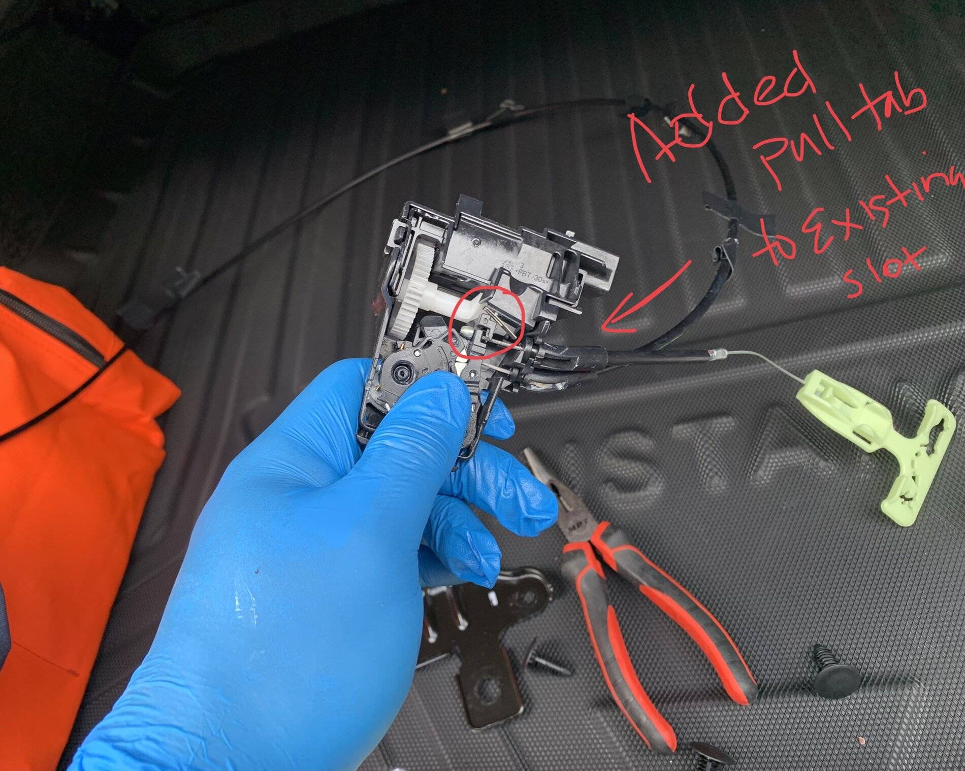

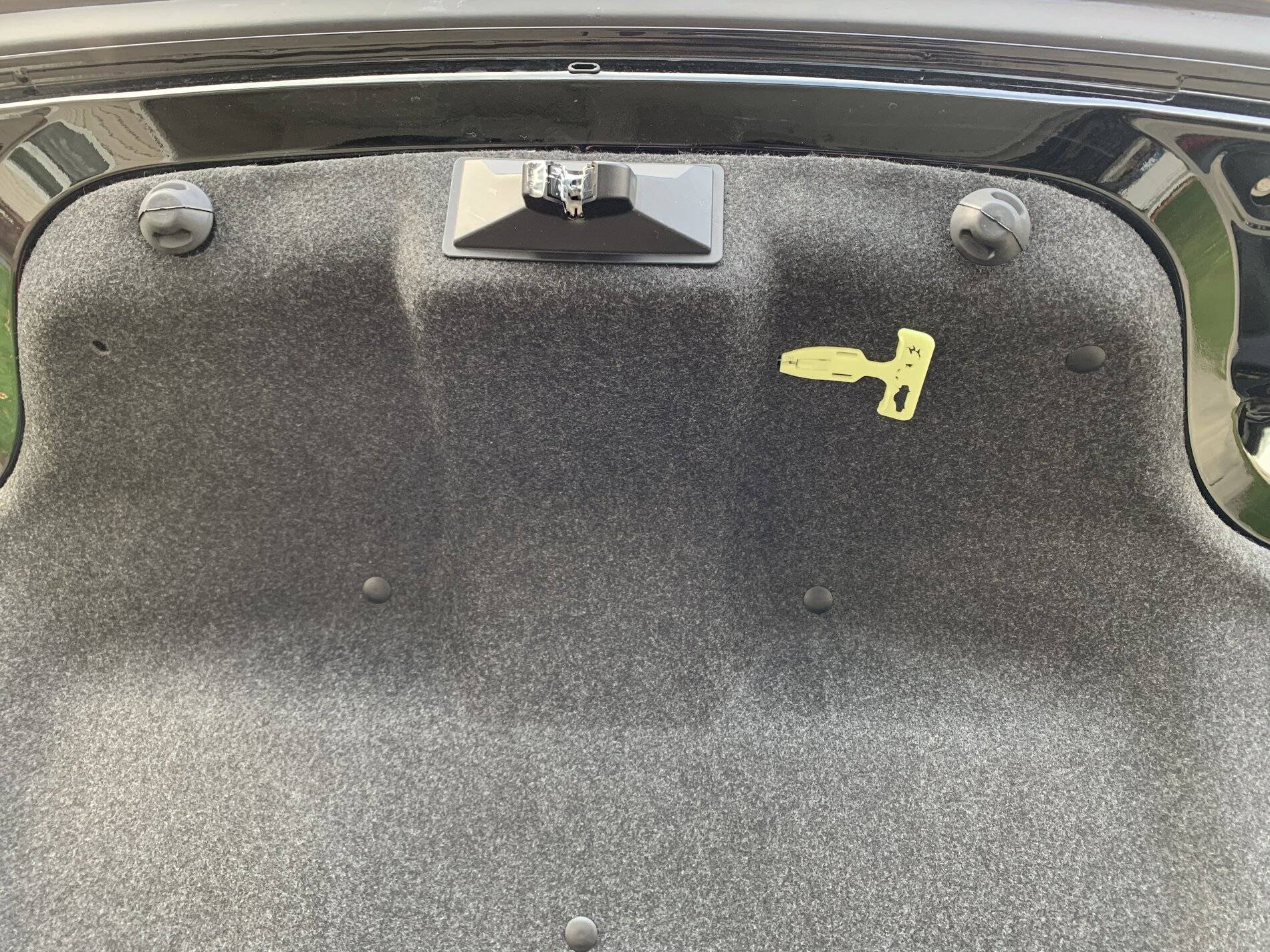

Update: I Fixed it!:like:
So If you’re looking up parts Trunk lock latch OEM 2015-2021 Convertible, This is what shows up:
FR3Z7643200C- For CONVERTIBLE, w/theft deterrent. Mustang; Convertible; w/Thatcham Security. (Did not come with the Glow in the dark pull tab and short cable) This is what I ordered, turned out to be wrong part.
FR3Z7643200B- For CONVERTIBLE, w/o theft deterrent. Mustang; Convertible. Mustang; Convertible; w/o Thatcham Security.
To make it more confusing…

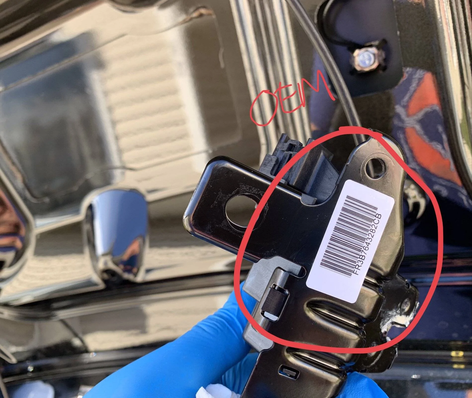

The one on my Convertible (401A with Extra security package)
is part #FR3B7643282CB. The internals are similar to the 200C, and same attachment point for the electronic harness. I cannot find this part for sale at any online dealer.

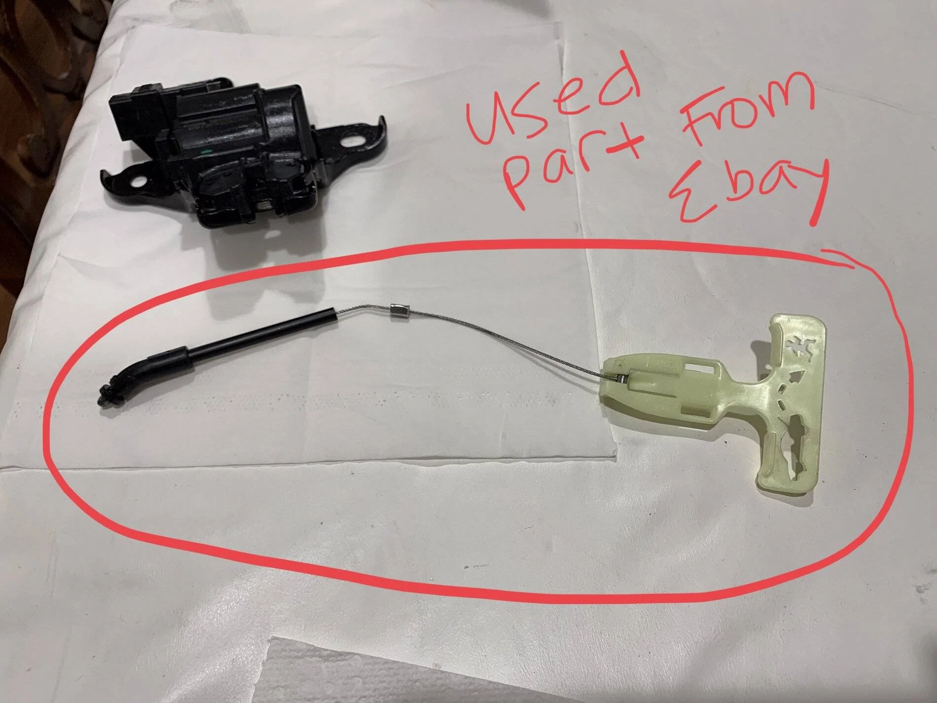

I ended up just getting the short cable and glow in the dark pull tab from a used FordFusion part on ebay. (see pic) Afaik, they dont sell this short cable together with the glow tab handle. (which sucks).
This is a bit of a pita, It should really come with it…For me its not a big deal, but a nuissance still. I was able to fix it and put it together in about 20 minutes.
I do most of my wrenching, (harleys, cars, trucks etc) But for someone who’s not use to it, It would be a nightmare taking the latch apart, then lining up the springs, while putting it back together! lol
