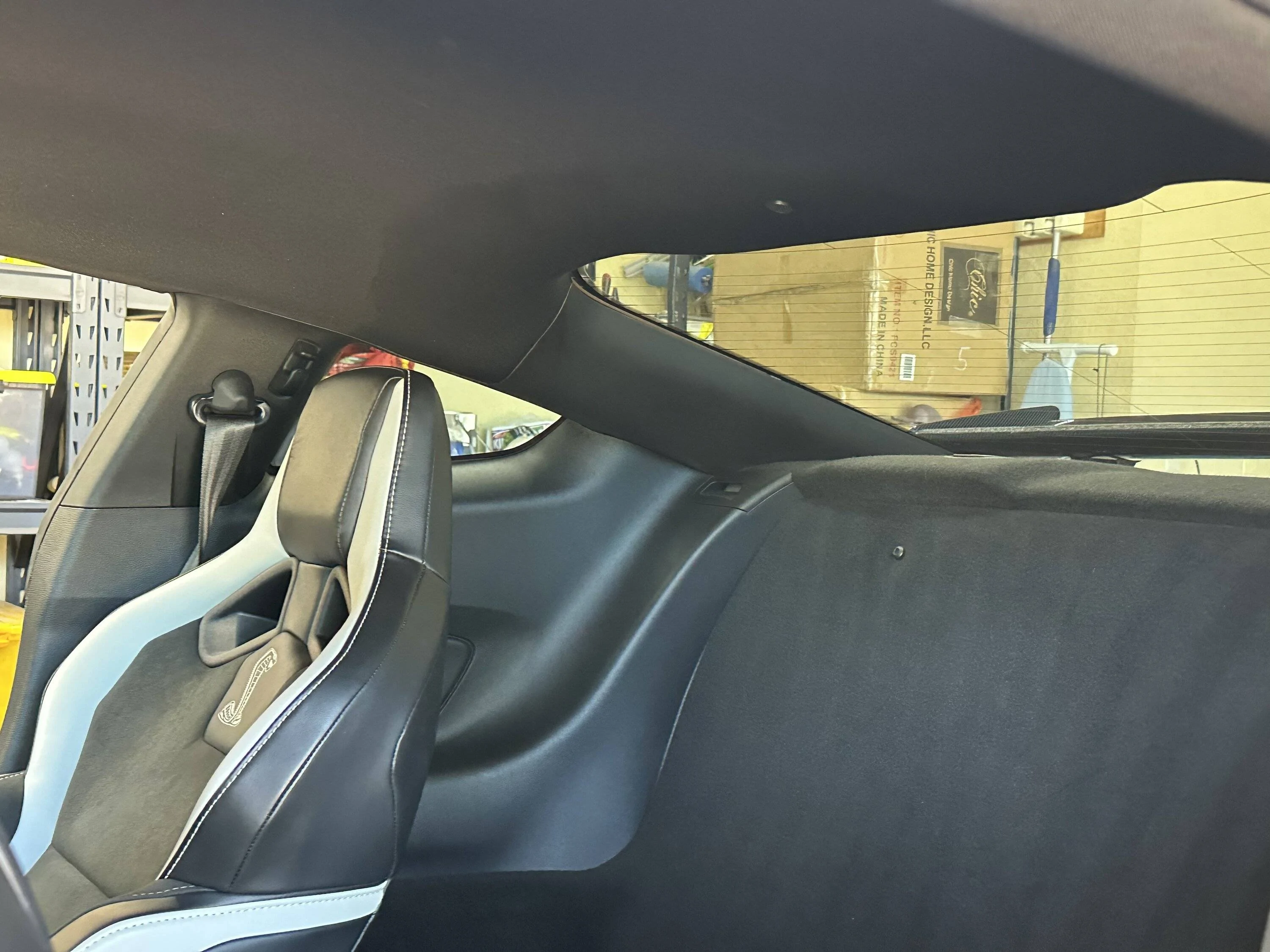

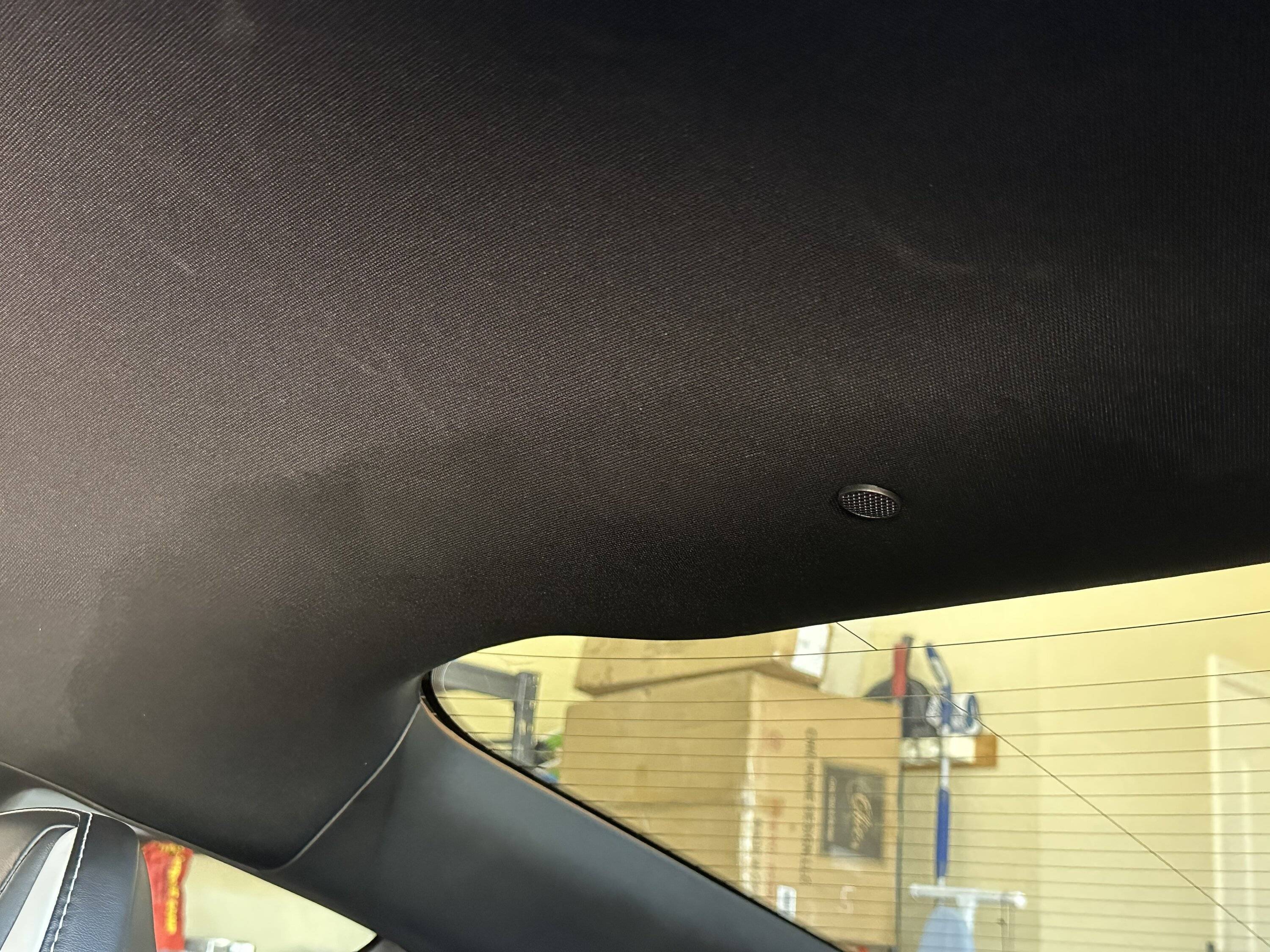

I’m in the middle of washing my car and I just noticed water in the back right headliner, and some that had dripped down into the passenger rear seat area. I did not use high-pressure water. I used hose pressure water on the car. I’m assuming this is probably a bad rear window seal. Anyone have this happen?

I'm not the expert and water can travel strange ways, but..........based on the picture of the headliner, I would guess it is leaking around the antenna base and the cut-out in the roof. The antenna is held down by a simple stud and washer/ nut under the headliner.

I have read about the third brake light being the culprit for rear window leaks. Hope you find it because that sucks.

I’ve had similar issue’s with the cab lights on both my service trucks. One was a 19/450 and my current 20/550. The screw holes didn’t seal well with the gasket material that’s used. Interestingly, my 22/450 Platinum personal truck has had zero issue’s with this. Ford did change the way the seals are on that truck. I would push for the headliner to be replaced as well. Water damage(stains)has a nasty habit of popping up down the road even when there not present initially.

Yes i agree . I could see the headliner potentially coming apart from the moisture.

I finally got around to dropping my car off. Ford says the leak is coming from around the rear brake light at the top of the window. They are going to replace that brake light as well as put in a new headliner under warranty.
