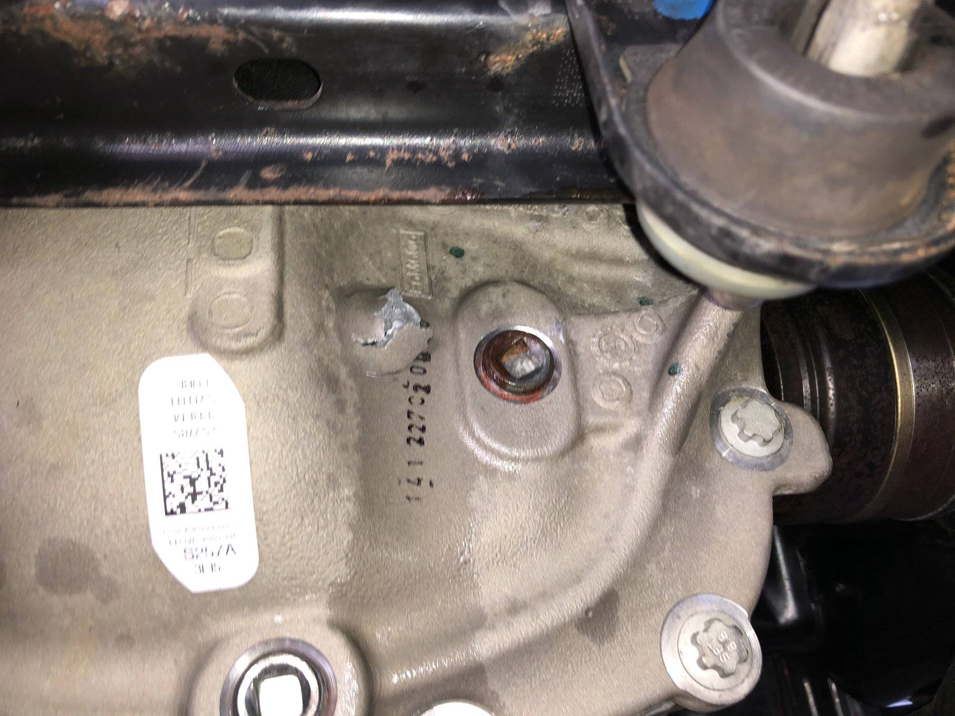

I have a used iron housing differential from a 2015+ stick car on the way from Montreal.
I hope this will hold up as I plan on throwing some boost at the car. It broke with only 10 psi on E85. ‍
I was planning on running 16-22 psi if the track held the car.
Oh well.
Break, race & repeat.
