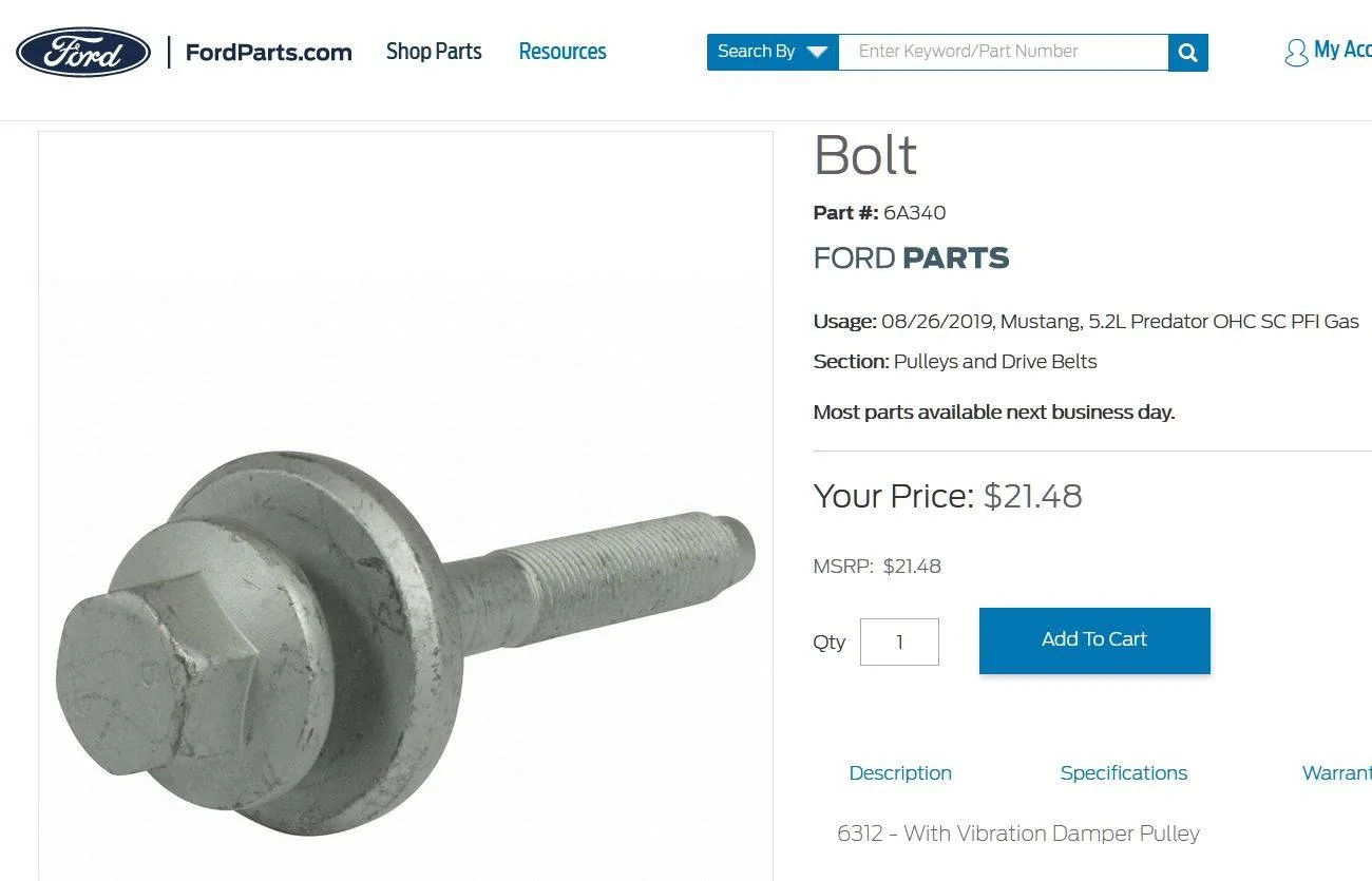

I'd venture to guess you may not get an answer. You can order one cheap though and dimension it on your own...
AL3Z-6A340-A

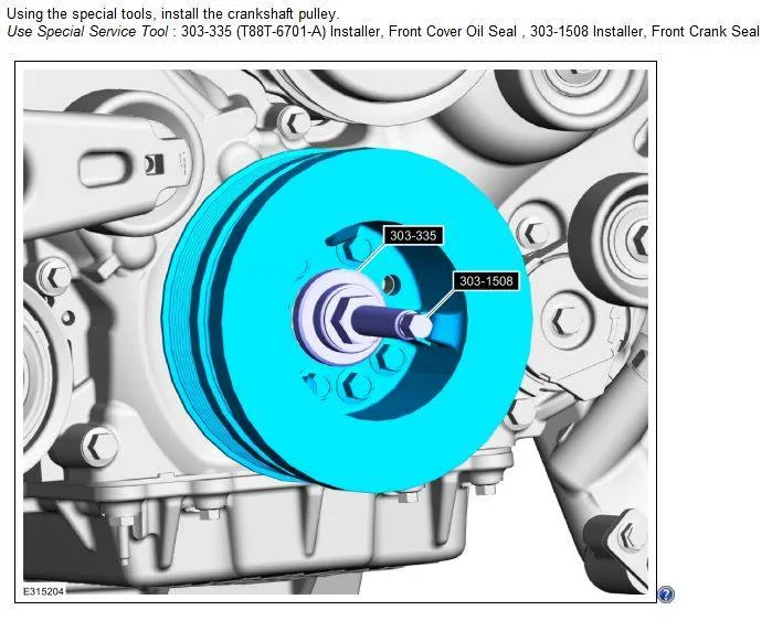

Wait. So you just want a longer fastener to reinstall the front balancer? Why not use the right tool for the job?
From the Ford service manual for the 2020 Predator 5.2L Engine...
NOT the CORRECT tools for R/R the CRANKSHAFT PULLEY!!!
303-1508 IS FOR INSTALLING THE FRONT CRANK SEAL.
303-335 IS FOR INSTALLING THE FRONT COVER OIL SEAL.
OTC-6930 IS FOR REMOVING THE CRANK PULLEY WITH THE OTC-8052 STEP PLATE.

Uh....what? That is the factory tool to pull the assembly back on, whereby the service replacement bolt can then be installed.
