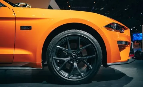

The 2020 EB HiPo if opted with the Handling Package comes with these rims, which are 19x9.5 “squared”:

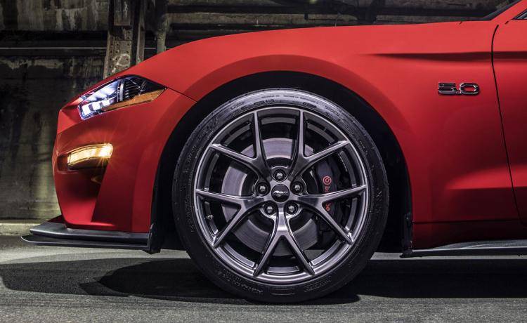

but are only visually similar to the 2018+ GTPP2 rims (which are staggered; 10.5 fronts and 11 rears):
Based on multiple online pictures of the 2 Mustang platforms, it also looks like the 2020 EB HiPo Handling Package rims are a darker shade of gray than the 2018-current GTPP2 rims.
All of the EB w/ PP from 2015-current were always equipped with squared 19x9 front and rear rims. 2020 is the first EB PP (HiPo w/Handling Package) to get a squared 19x9.5 rim.
