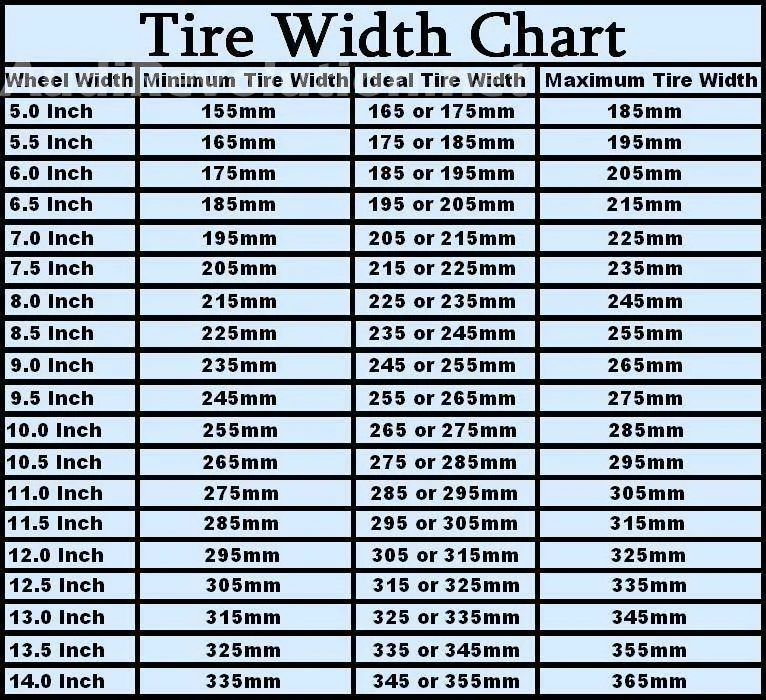

When I was looking at winter tires, I used this chart to see what tires fit what rims:
It gave me an idea what will fit the stock rims and what will fit a small width rim. I chose the 275/35R19 based on it being the narrowest the 11" rear rims will fit and I could still use them if I wanted to go down to 19" x 9.5. Later, I could use the 19"x 9.5" to fit a 245 or 255 width winter tire if I find the 275 do not perform well. I suspect they will not which is why I will be putting some weight in the trunk as well. If the tires work well enough, I may go to a 19" x9" rim or 19" x 8.5" and get a 235 width tire for the winter.
