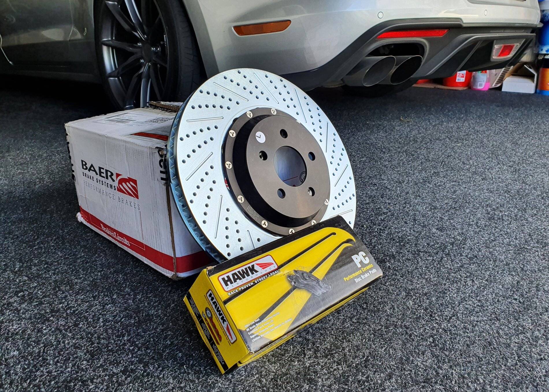

Russ
2020 GT PP1
Ive just scored 2 pce Baer's front and rear..
