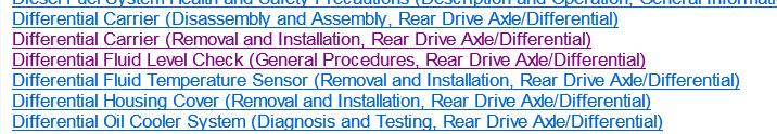

Anyone else get the 2019 Service Manual? Mine doesn't have any information on changing the oil in the 5.0 (only 5.2) and no reference to changing the diff fluid. It only talk about checking diff fluid level. I thought it would specify what size tool is used to remove\replace the drain and fill plugs. I can figure it out but still, seems incomplete for the price paid.

Yes I was able to find the capacities in the specifications section. However, do I torque the diff drain plug the same as the fill plug (25 ft lbs)? I haven't seen that in the service manual as of yet.

Thanks. I found it finally but I find the navigation of the manual a bit un-intuitive. One part of the manual has information about filling but then you have to go to another part to find information on draining...which also includes information on filling. Still haven't found the the detailed info on doing an oil change on the 5.0 (only the 5.2). Maybe they are the same. I don't think I'll have any problems changing the oil but it's just odd that the information isn't in the same general area as the info for the 5.2.

Yah, seems to be a bit difficult to navigate for sure. Some things seem intuitive but others seem complex.

The only place I found information on oil change is under "removal and installation - oil pan". Yep, difficult to navigate!
