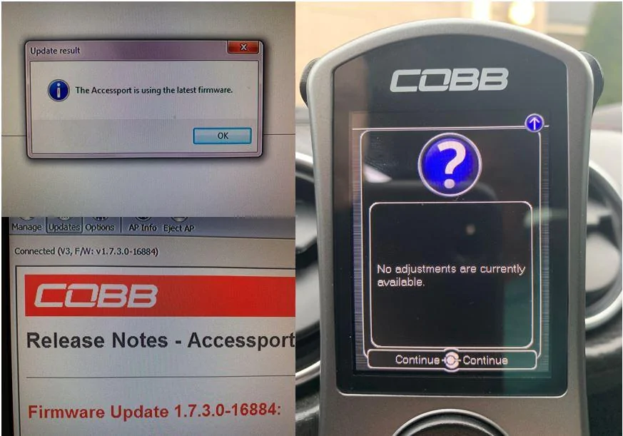

Hi Kyle,
I Tried updating the firmware via AP Manager. Window pops up saying I have the latest firmware installed. Plugged AP into the car, went to the tune menu and selected Restore OTS Maps. Took the car out for a spirited drive and hit the limiter at 122. Also, under the ECU adjustments menu there are no features available. It says No adjustments currently available. Is the bump box, two step and trans brake features not available for the 2018 model?
