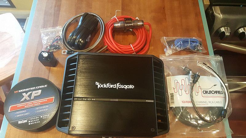

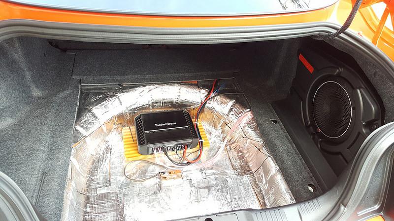

I replaced the factory sub speaker with a RF and added an amp to drive it.
I disconnected the little factory sub amp, and took the signal off the rear speakers.
Power cable straight from the battery. Total cost was about $500.
While this is an excellent option and a possibility I've also read comments on here where while an improvement over the factory sub, the RF upgrade wasn't as dramatic of an improvement as expected. I'm just hoping someone has worked with other options in a convertible and can provide some additional feedback. Thanks for the input and I certainly appreciate it.
