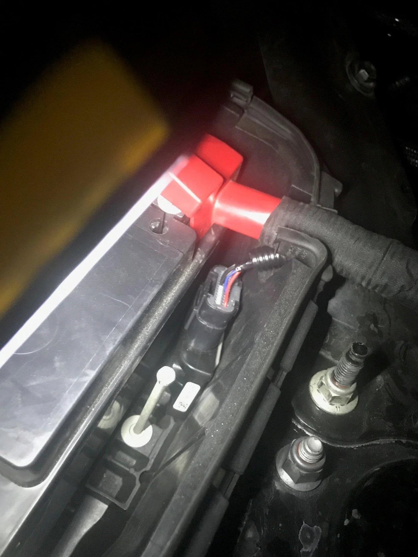

The early 2018 Roush supercharger kits used an analog gt350 throttle body. Roush used a sent module adapter to convert the analog data to digital. This adapter is located in your battery box. Roush is now shipping a digital throttle body with the kits. Have your dealer contact Gavin at Roush and have them replace the throttle body with a new digital one. I got mine replaced.

I had a quick look last night. It appears my setup has the early analog throttle body. I will be making some phone calls today. Thanks for the heads up.

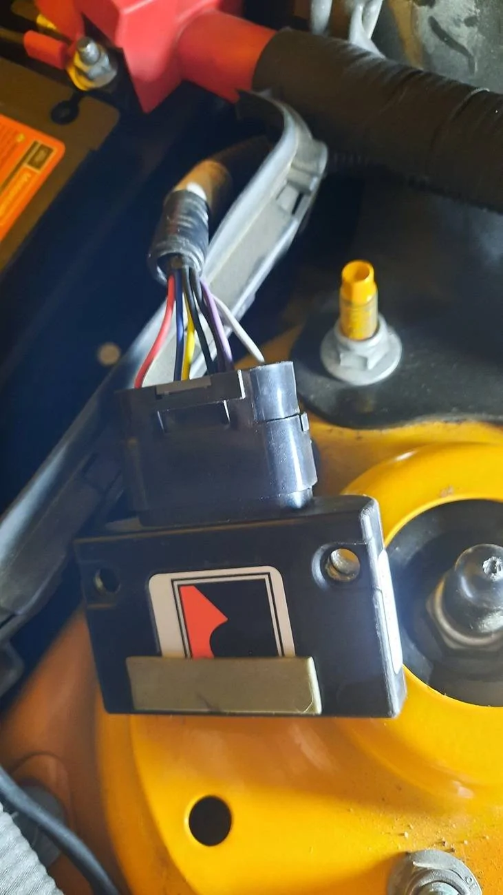

So... This looks to be the old style?

Chainsaw

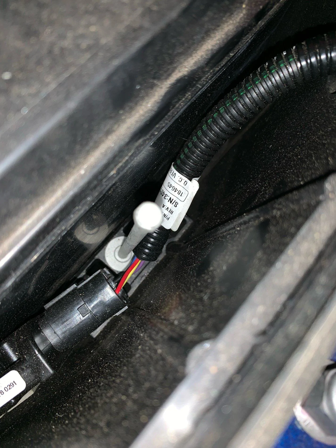

I contacted Roush and spoke with Jeffrey Moore of Technical Support. He was very helpful with diagnosing my vehicle's issues. Here is what he replied back to me in an email: "Anytime we see these two codes (P0120 & P0124) together on our Roush 18-21 kit, it indicates the SENT module is going bad."
As instructed by Mr. Moore, I ordered a Bullitt throttle body M-9926-M50B to replace the current throttle body. Mr. Moore stated: " You will no longer need the SENT module. We recommend you discard that and the harness that goes from the SENT module to the throttle body, along with the old throttle body, and replace them with the M-9926-M5 0B throttle body. "
I am now waiting on the replacement Bullitt throttle body M-9926-M50B shipment, so I can do the modifications needed.

April 7, 2025 update:
This weekend my son and I replaced the analog GT350 throttle body (TB) with the 2019 Bullitt digital TB I received from Summit.
Jeffrey Moore of the Roush Performance technical support desk supplied instructions and a Roush software PCM update to my Roush Stage 1 TVS 2650 setup. The update was flashed into the vehicle's PCM using the Dash Logic dashbridge CX interface with the Roush Diagnostic Tool (RDT) software..
Long story short, the flash and throttle body replacement was successful. The new updated tune started the vehicle immediately. Test drives were successful! No Ford Service Center was involved with the process. This should take care of the P0120 and P0124 codes caused by the analog to digital conversion module and the GT350 TB.
