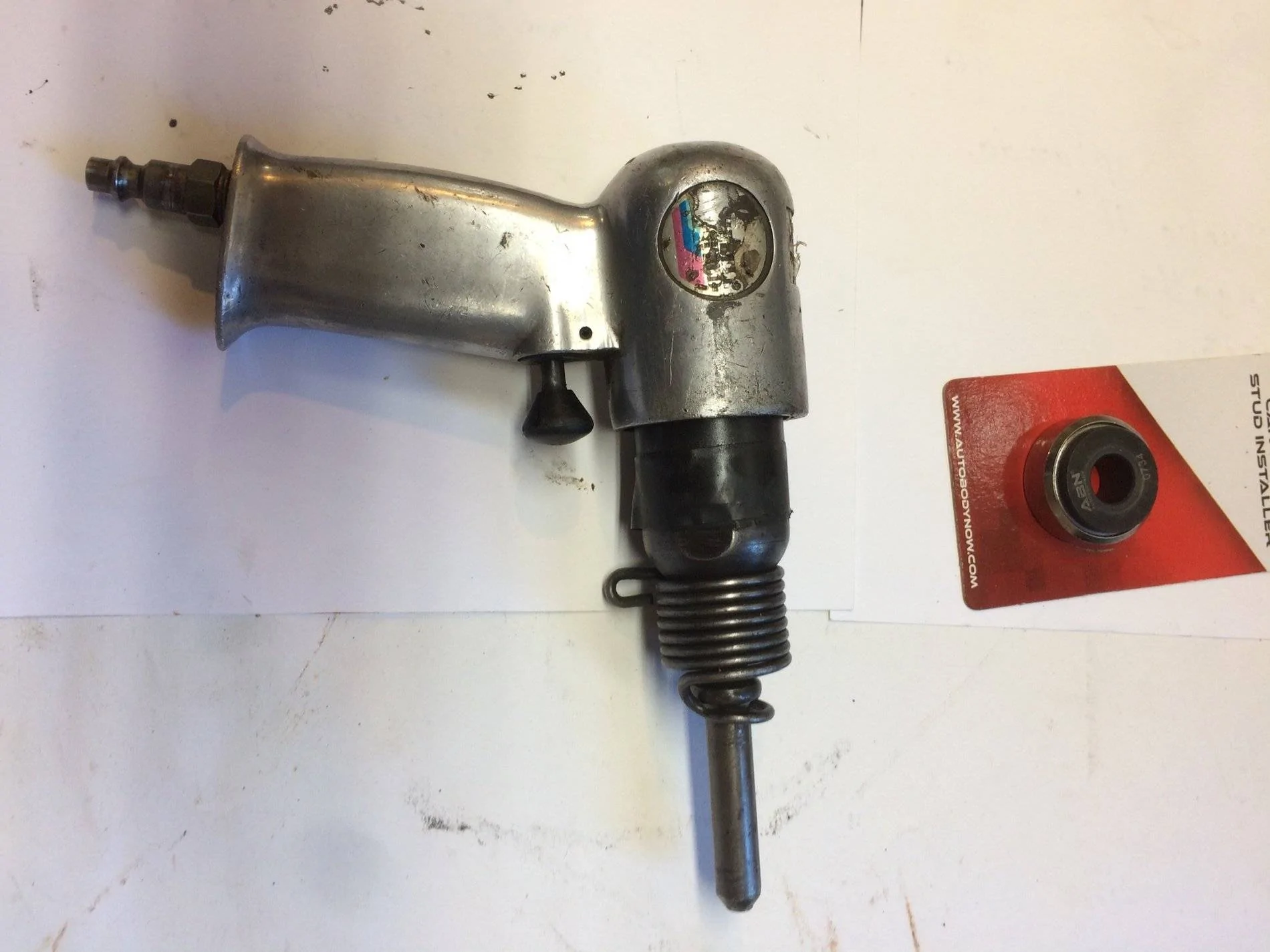

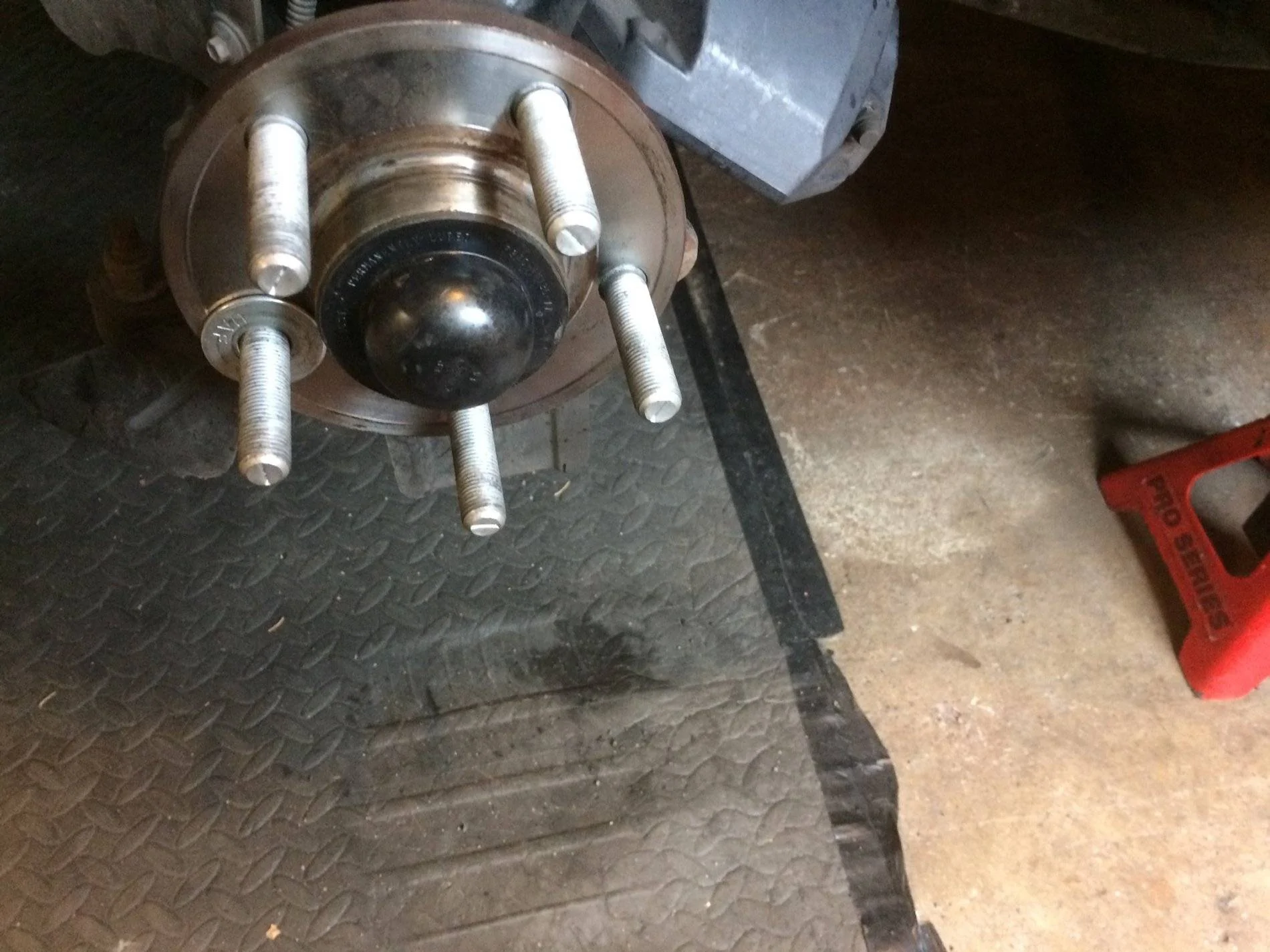

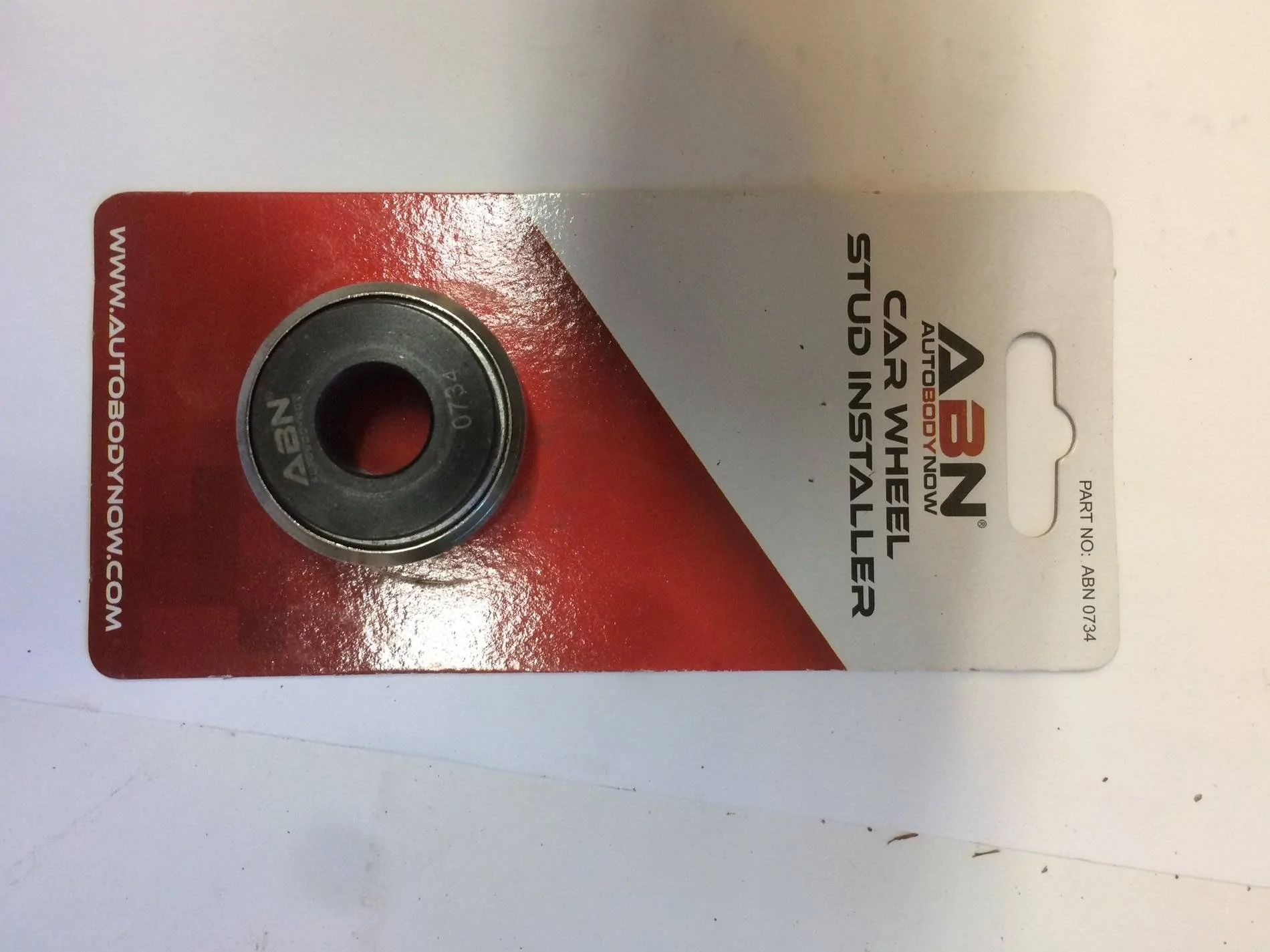

I added 15mm spacers to the front and rear. I didn’t want any ā€œpokeā€ that I thought I might get with 25mm spacers. I did have to replace the studs.
The front is pretty easy if you’re mechanically inclined at all. You can replace the studs w/o taking the hubs off, simply push out the OEM studs and pull in the longer studs.
If you have access to the tools in the pics it simplifies the job.

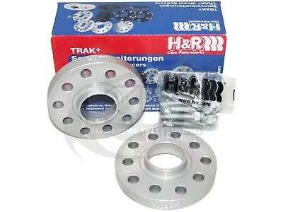

Basically you have three options:
Small bolt through spacers, limited to a max of about 6mm or 1/4" thick, that will work with the stock studs.
Bolt through spacers with longer studs, probably gets you to a max of 30mm thick with the normally available extended (+1"/25mm) studs.
Bolt on spacers, which are limited to a MINIMUM of about 20mm to clear the inner lug nuts.
I wouldn't use bolt on spacers for serious performance applications as they double the failure rate/number of joints for the hub to wheel connection.

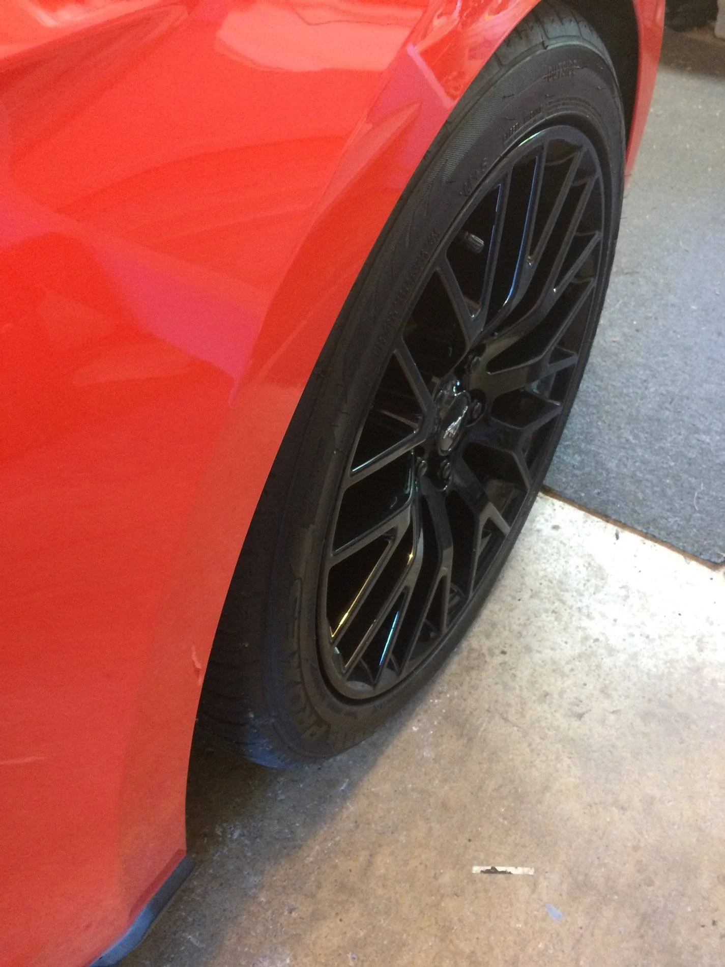

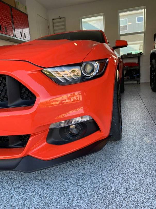

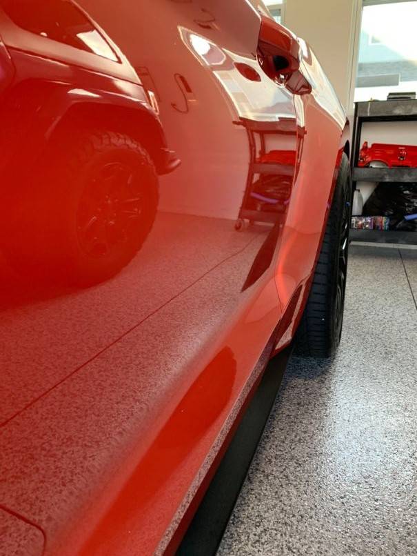

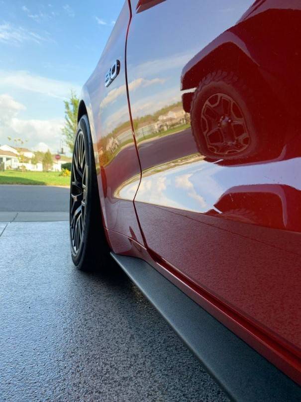

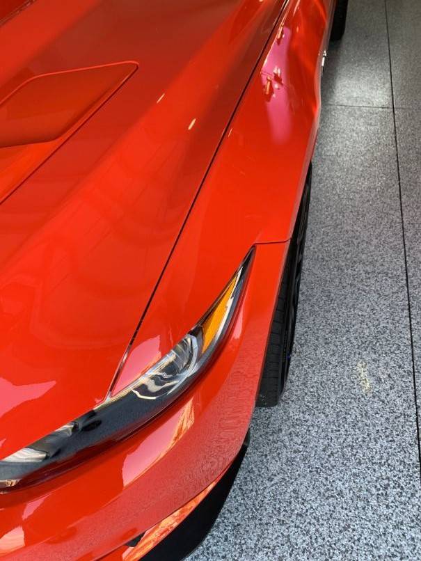

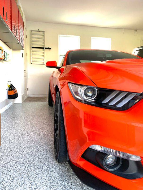

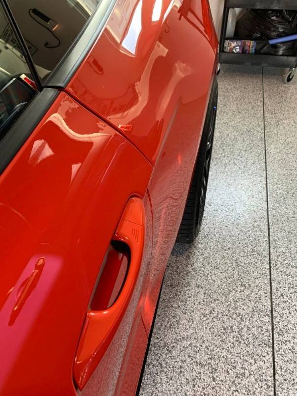

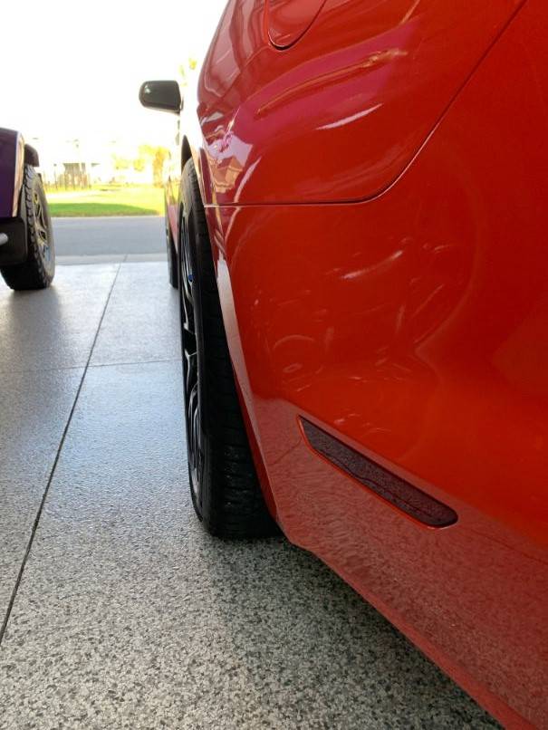

On my stock PP1 wheels, I used 1" spacers all around front and rear. The stance with the spacers was just perfect, I was surprised at how well it worked and really changed the look of the car. The rear did not poke too far, gave it a nice muscular look, and the fronts sat out exactly in line with the top of the fender flare. I did not have any issues with rock toss up, or even really any water spraying down the side of the car. I am pretty OCD about my car staying clean, so when I drive in the rain I hate when the tires spit up dirt on the sides of the car. Did not happen with the spacers, and I did not have mudflaps. Its probably because I still had the stock Pirelli tires, which have a rounded enough shoulder that tread doesn't stick out past the fender enough to matter.
I would definitely recommend the 1" spacers for stock wheels. Attaching some pics...
