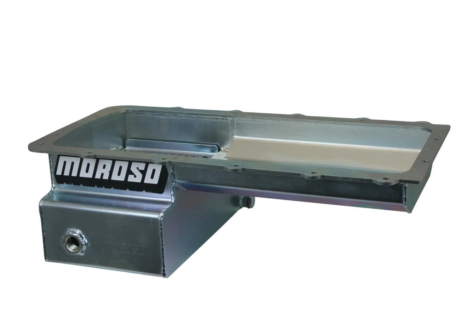

is there a good way to tap the pan? Where else to run oil return lines? Thought I had seen a post on it but could not find it.

on the last 18 JTB install, the pan was tapped in the front at the top, dead center. Since the pan is plastic it was sealed with epoxy to prevent it from leaking. The pan is not pressurized so as long as your fitting doesnt leak or fall off, send it
