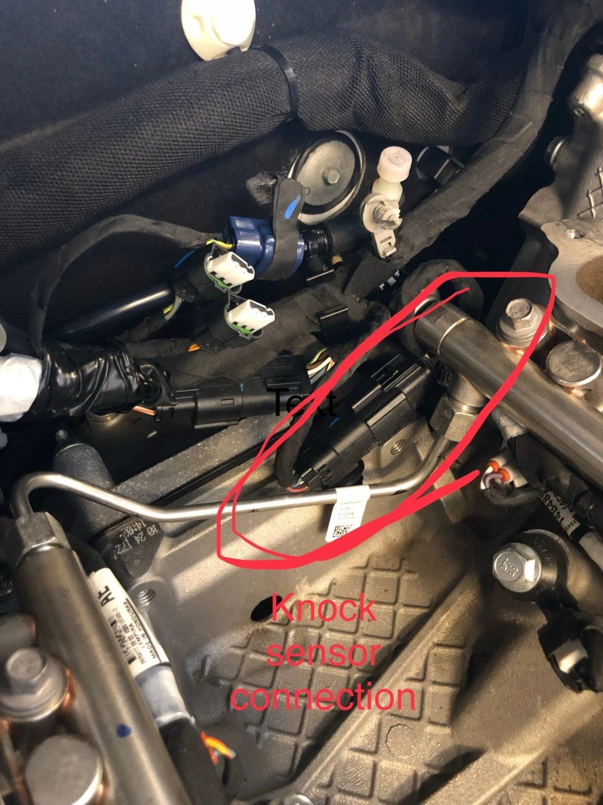

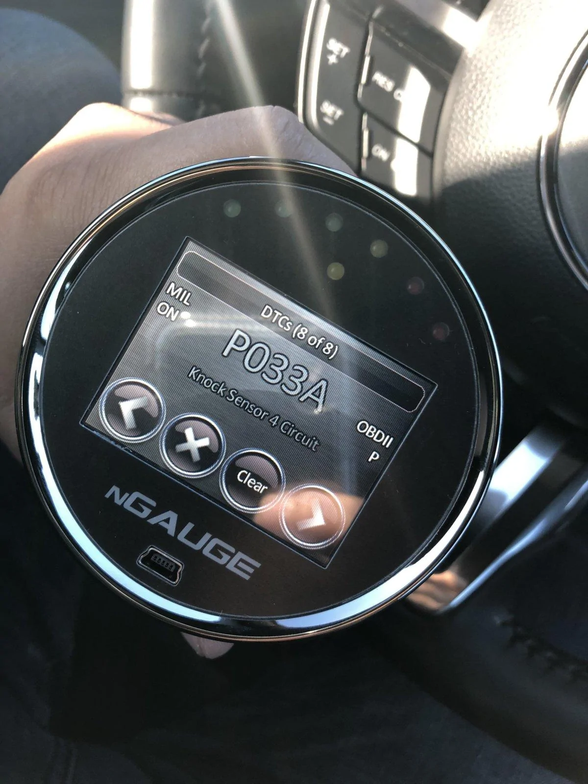

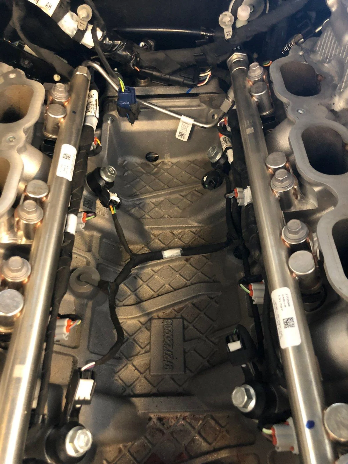

I just wrapped up on the install of my whipple on my 18 gt. I got some knock sensor circuit codes and I honestly don’t recall unplugging them. This however made me doubt that maybe the location on them isn’t where the other coyote cars were. Does anyone have a photo of where they’re located in the 18’s?

Not a lot of light down there to see but it looks like there might be 4 of them. My 16 has two.
At least I see 4 wires.

Yes that’s what I thought as well, but I’m doubting myself lol

typically you must seperate them from shielding a bit and move them out of the way. If you didnt you might have pinched a wire.

You don’t have to adjust the sensors or move the wiring on the 2018.

Pinched wire I’m assuming. Removed blower to inspect, didn’t see anything, put back on and was fine lol. Gone 9.1’s and 155’s since
