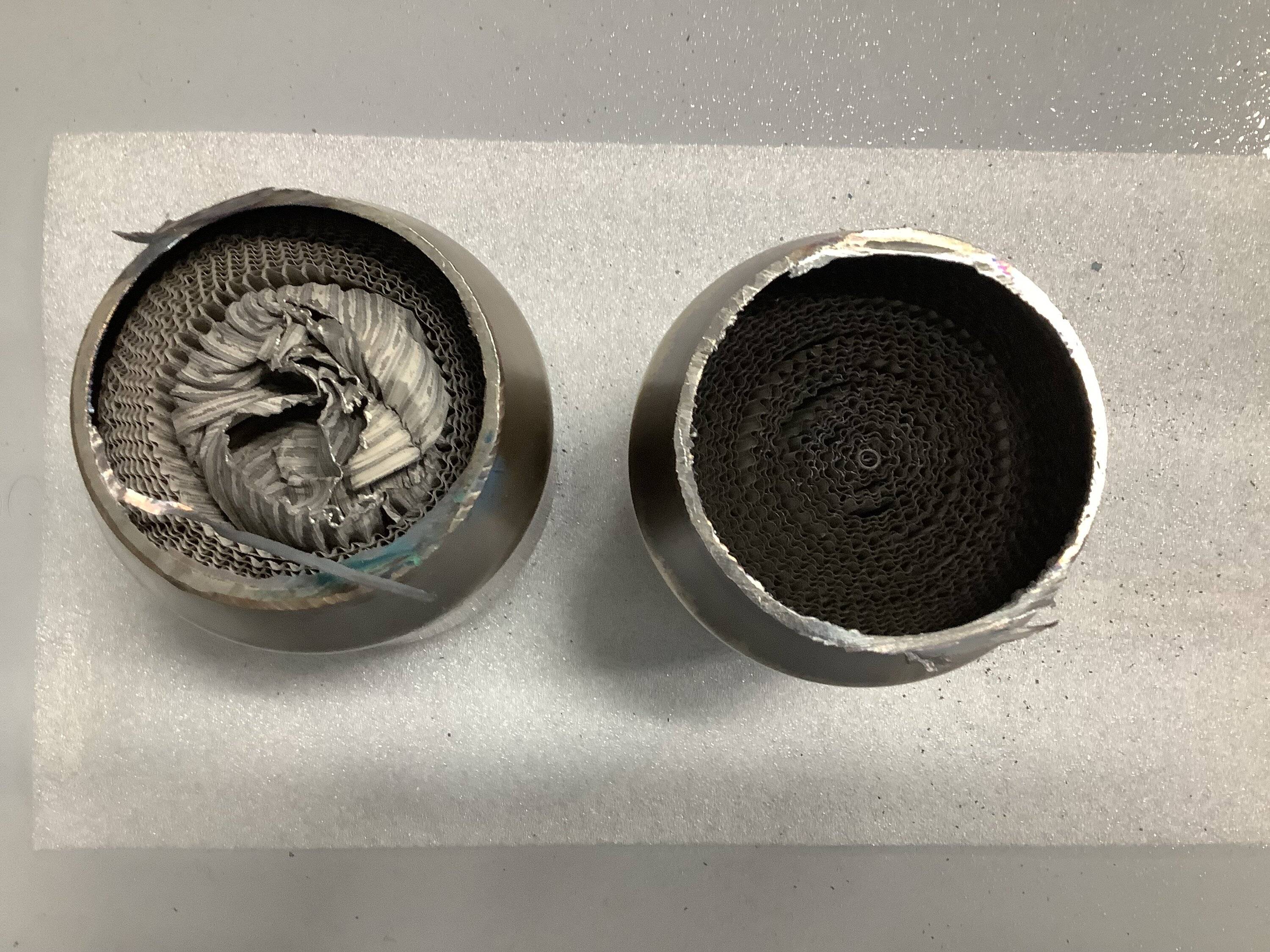

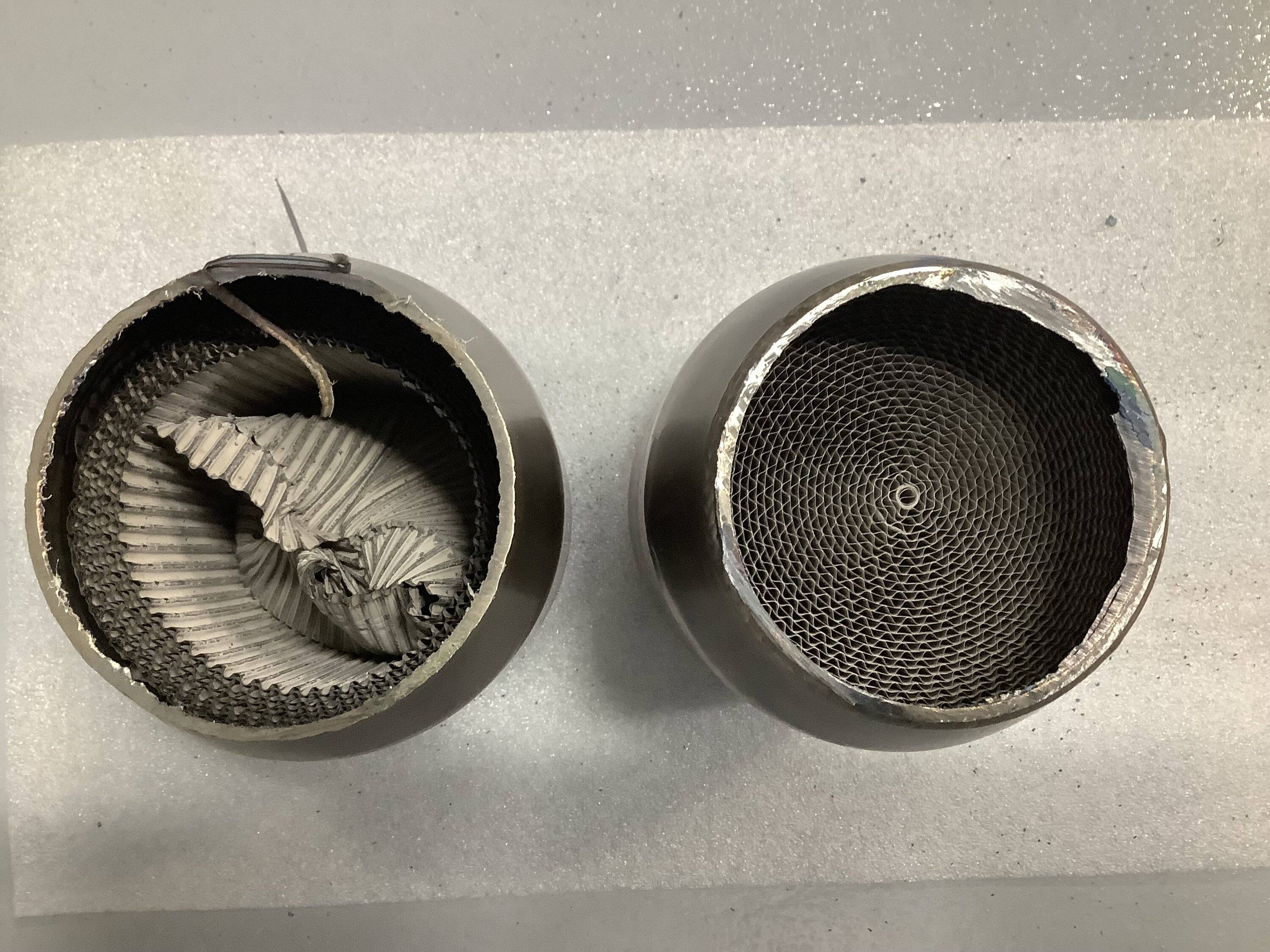

If you will be going boosted at some point, or running a WOT Box (2 step), consider going catless to prevent the risk of blowing out or melting down the cats. I‘m going through this issue now. Looking back on it now, I believe the problem had existed for a while and was continually worsening over time until it finally reared its ugly head last week.
