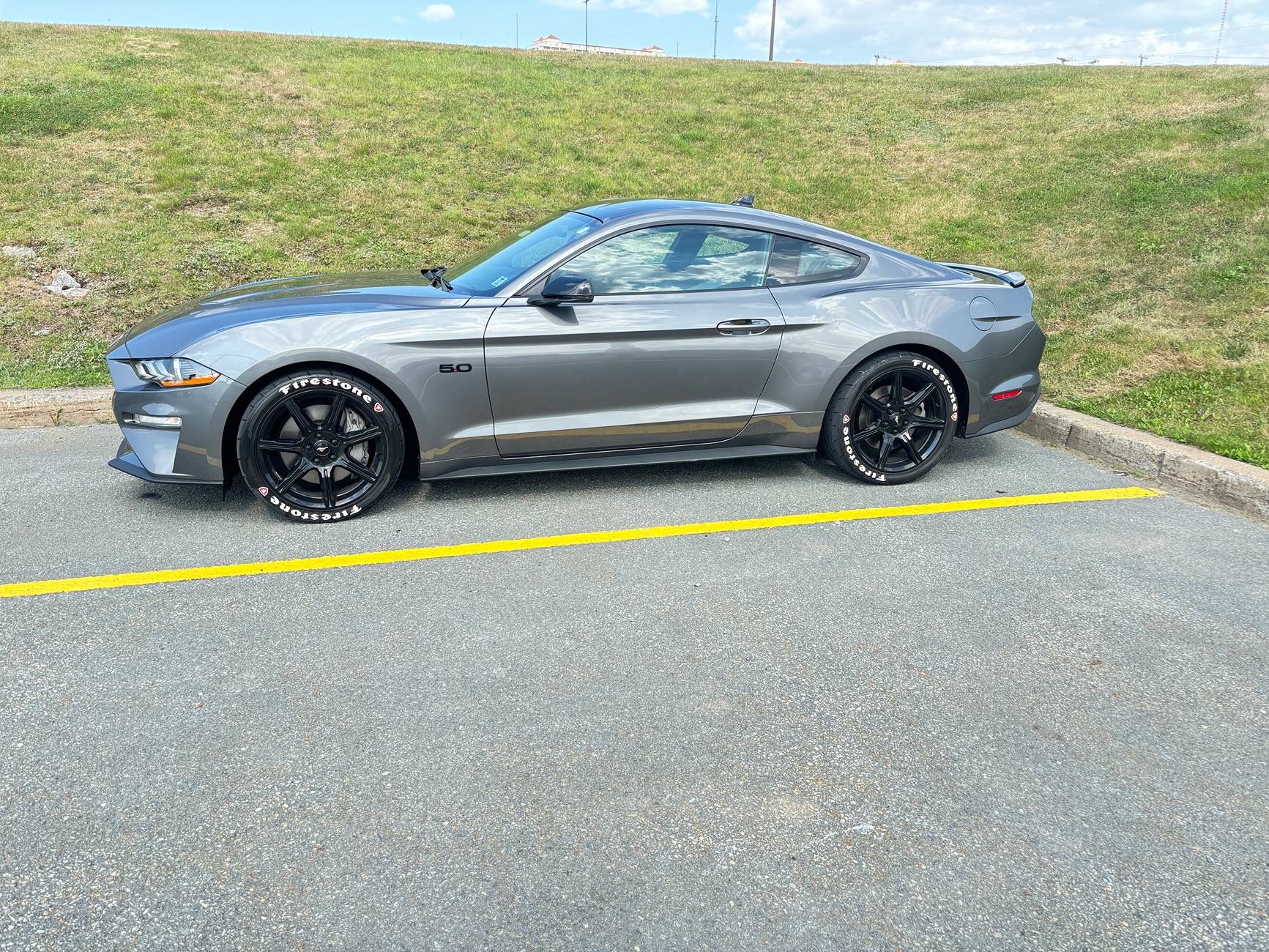

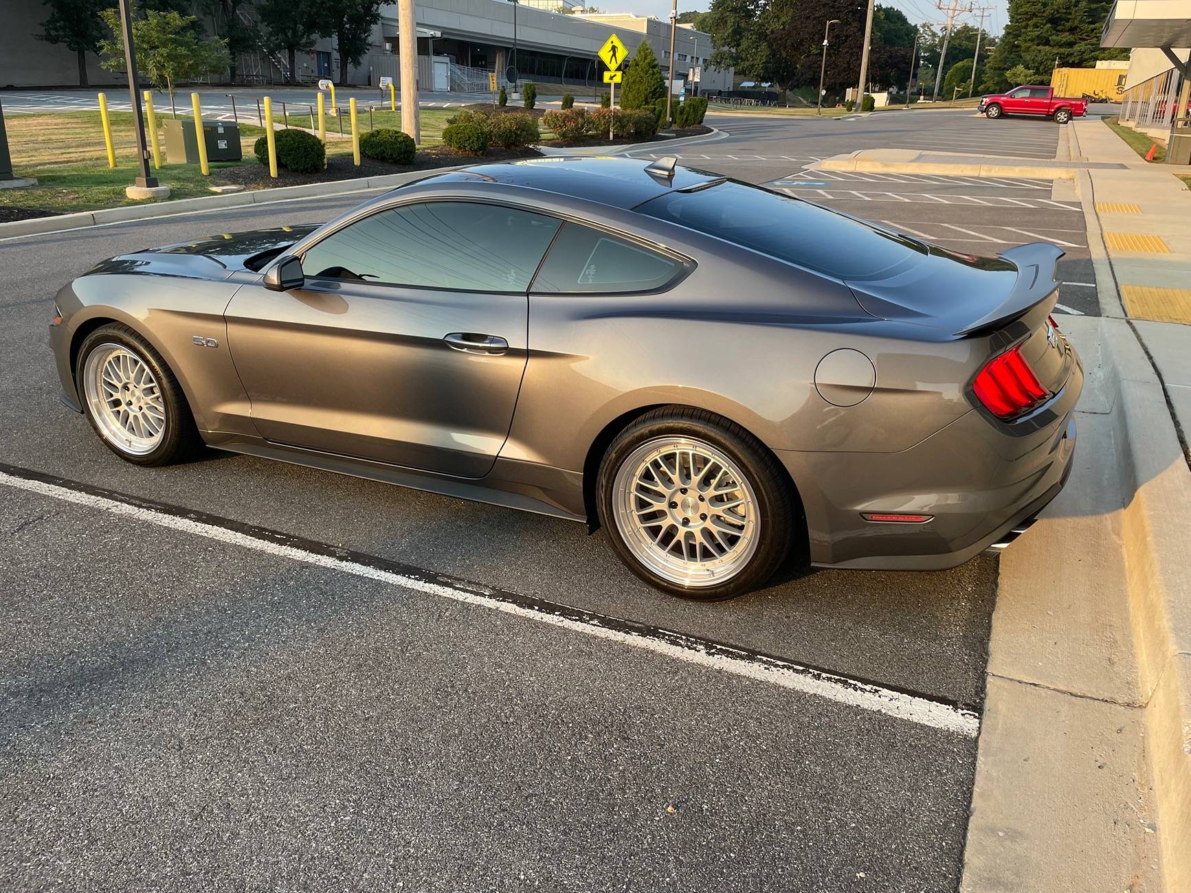

what color did you get?
mine is Carbonized Grey Metallic
quite a few changes since I got it; just need the new springs as the last piece of the puzzle

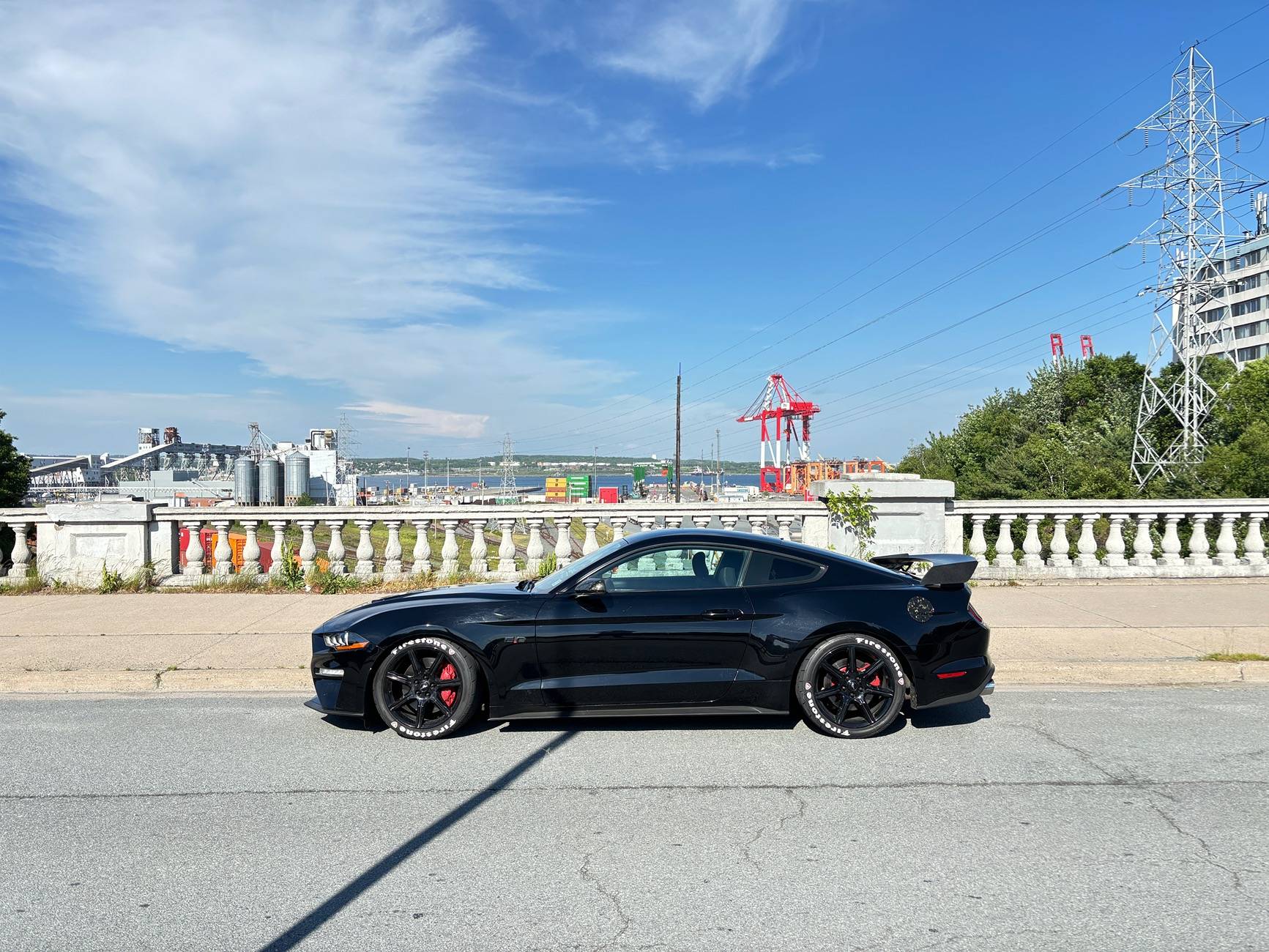

Man she’s a beauty! Funny enough my new one is the exact same color.
Here’s the old vs new
dealer wanted to keep my wing on the old one and the exhaust so I ordered a new one already 😂.
going to just go with an x pipe on the new since it has active exhaust and hope it’s loud enough.
probably paint my calipers red again as well as it really makes them pop.

The white letters on the tires is also a nice touch
