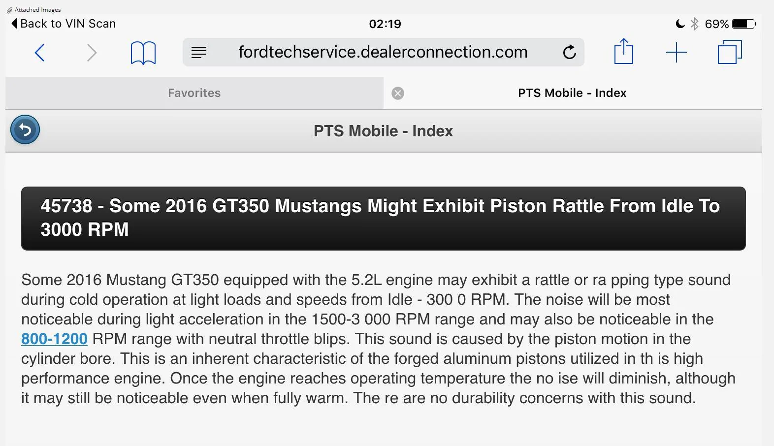

This was pulled from a GT350 site.. Not sure if I can link the page, but here is the SSM from Ford regarding the GT350 and forged pistons...
Are the pistons forged in the 18 motors?
