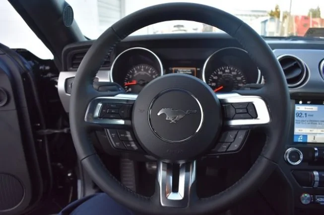

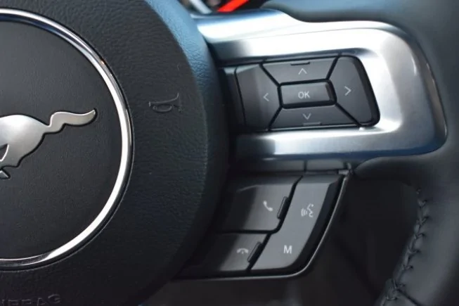

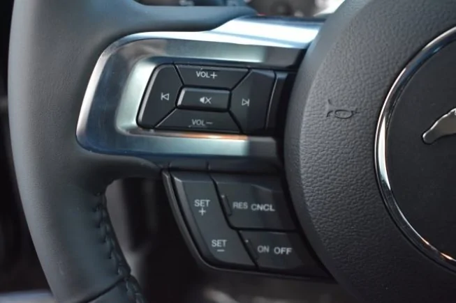

I'm going to throw a rock at the '18 301A to Digicluster swap. :( The '18 6-Speed 301A that I sat in did not have the pony button. I'm not going to lie I skimmed the last 3-4 pages to catch back up, if this has been discussed.. my apologies. I'm a little confused on if the Pony (My Mode?) button is strictly a control key, or if it needs to be coded in on the SCCM. The 301A obviously has Sync3, Drive Modes and no Pony Button. Would that screw anything?
I have a Manual 301A scheduled to be delivered on 1/22. I'm going to monitor yous dudes very closely, if you're thinking this could be a direct (or close) swap still I am ALL IN and will happily purchase/install/troubleshoot anything you all need. Thank you VERY MUCH for what you guys have done so far, please keep up the good work!

prolly will be the exact same as the 17 with the buttons just moved around honestly.
Attached is a 6-Speed 301A.
The lower button cluster where the pony button would need to be replaced with the pony button cluster. Other then that there might be an As Built data change required but your 18 SCCM will most likely accept the data change unlike the 15-17 modules due to updated firmware.
