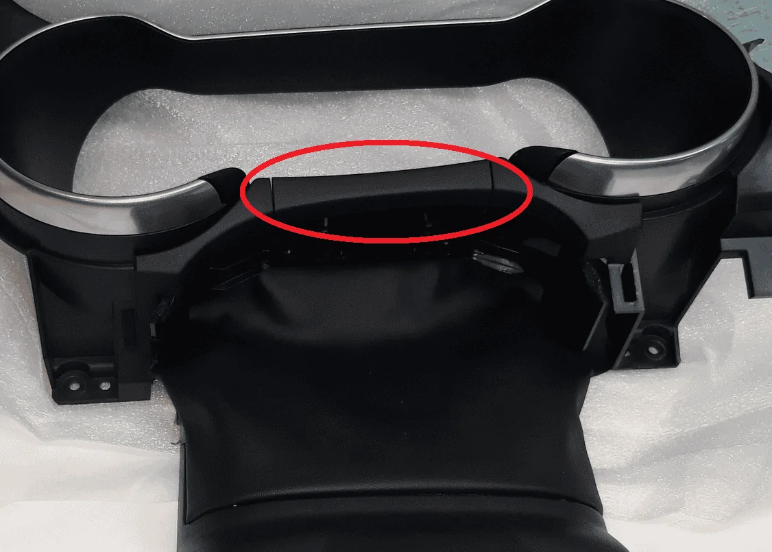

Anyone have one of these pieces laying around. No idea what happened to mine, but it came up missing before i did the digital cluster install.
Or if you have a part number that would be awesome too.

I believe the one off of your old Bezel will fit.

Unfortunately the piece on the analog cluster doesn’t fit, they’re slightly different sizes. I already tried that. Good thought though.
