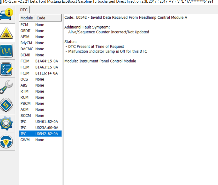

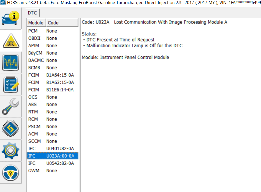

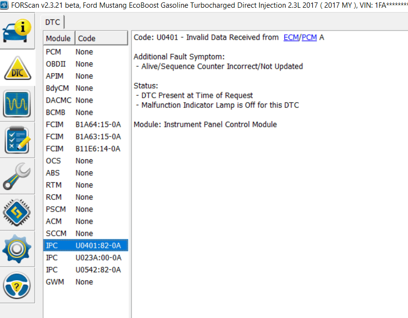

Has anyone encountered these errors. i was in forscan today and noticed those.
Any assistance would be greatly appreciated.
Thanks

Going to echo those above and say if you're even remotely worried about part quality/FORSCAN issues, just go with Sam.
This piece is too important to the safe operation of the vehicle to be playing roulette with some eBay unit or messing up the programming to save a few bucks which may end up costing you more in the long run.
The install is involved enough as is and you don't wanna get to the end only for the thing to not work. I'd pay the little extra for piece of mind and to support a fellow forum member.
