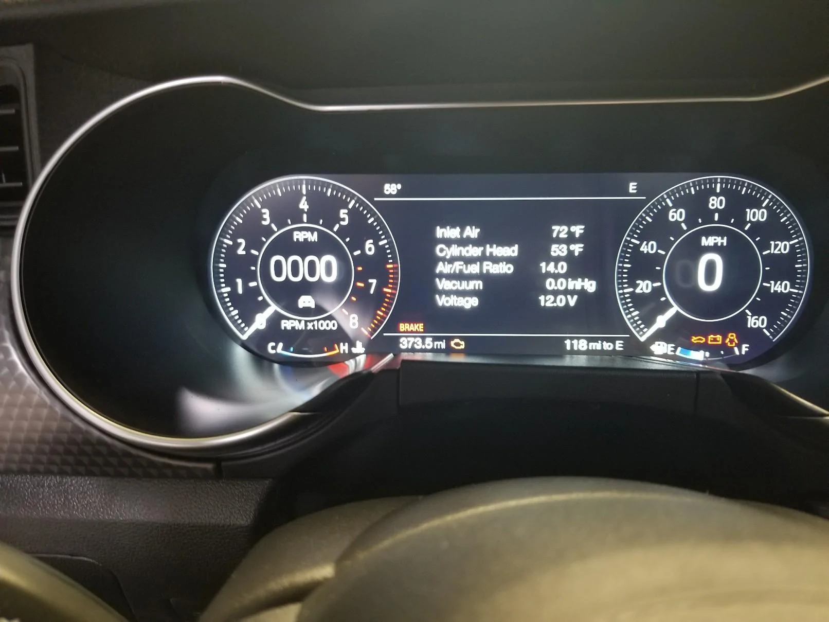

Is the cross traffic system fault message a glitch? I don't want to have any oddball warning messages when I complete mine. Also, ordered everything from Tasca and they cancelled my order for the SCCM portion because its backordered with no ETA. Probably just go local and place the order I guess.
The pic was before I did the programming, everything appears to be working correctly.
