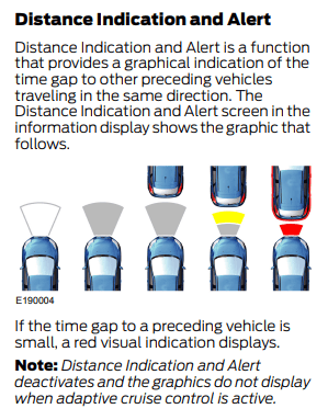

Distance Indication and Alert... that looks awful.
For all those times you find yourself staring at your dash instead of the car in front of you...

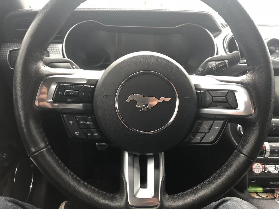

New buttons still have voice control. Its on the right side upper switch right hand button as you can see here:
Clearing codes (check engine light) does not do anything to the programming of any modules. Putting a tune on the car or returning to stock does not impact it either.

Thanks for clearing that up, I didn't realize that all the steering wheel buttons changed. I thought it was only the bottom right set.

The cruise does not change unless you have adaptive cruise already.
