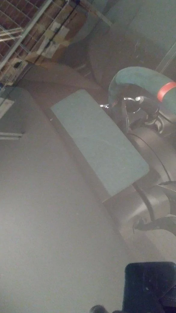

Glare Problem solved
the glare problem reared it's ugly head today as i was driving around, so decided to try something new. I determined it's caused by ANY sun light that manages to strike the ~5x5" panel right below the center of the display.
This time I tried to block it and was pleasantly surprised with the results, no more Glare.

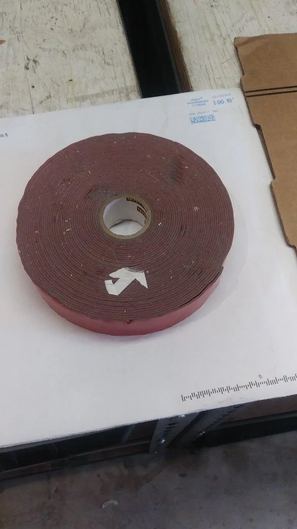

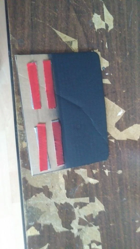

As proof of concept i used card board, but you can use any slightly flexible material, and paint it flat black, such as a piece of plastic. Suggest you cut a round on the edges that face you and maybe roughen the edge with sand paper to prevent an accident. Cut the piece to 5 1/2" x 7 1/2" and use a high quality double sided tape such as the 3M or Scotch 20lb or 30lb stuff, available at Lowes or HD. Cut the tape in half and place 2 rows, one no less than1/2" from the back edge and the 2nd row at about 2" from the same edge (edge that faces the dash). I suggest placing the tape on BEFORE you paint the material, so it sticks to the material when you slowly pry it off, if you remove the piece for any reason. Of course, you can play with the shape and dimensions to customize and improve on it..

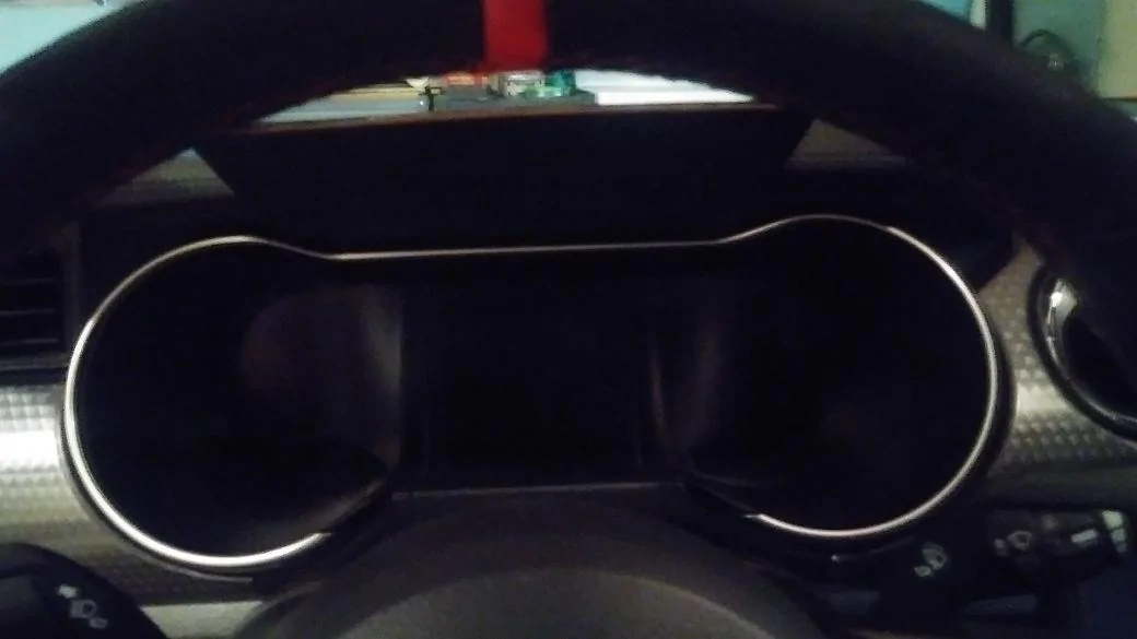

Looks pretty unobtrusive, don't really notice it, doesn't interfere with the steering wheel, and does it's job. Have a great day. :thumbsup:
Works.
