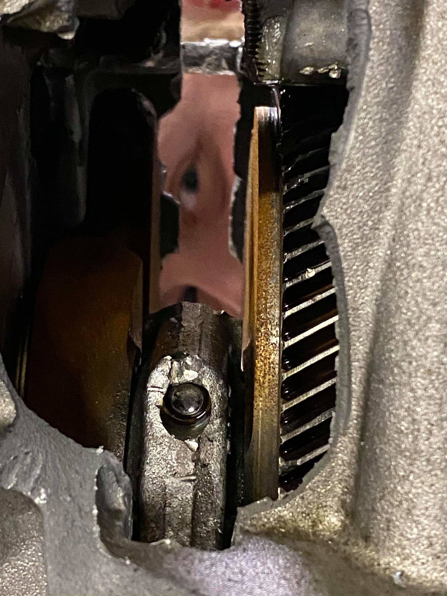

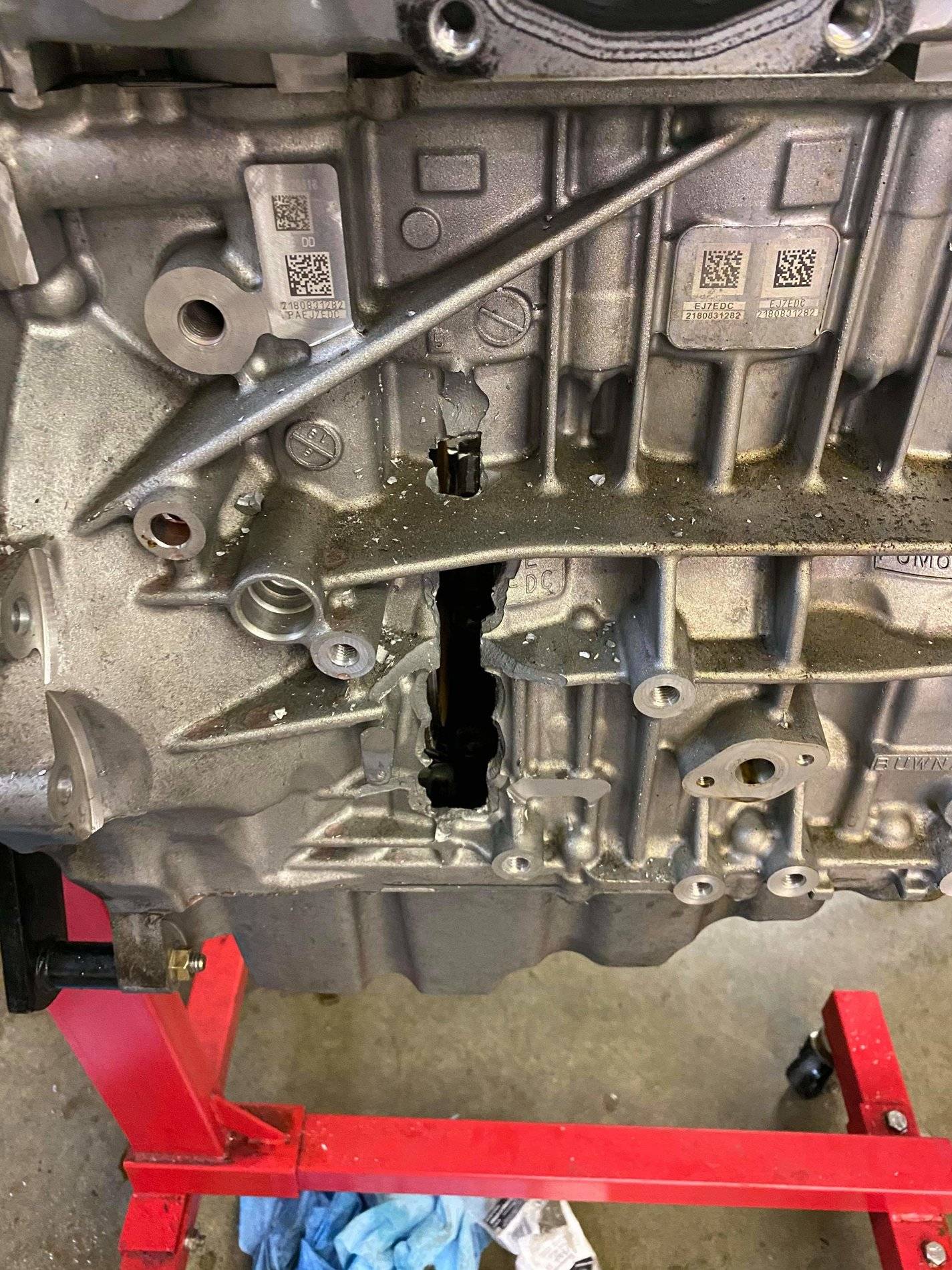

Less than 100 miles later on the tune, the car threw two rods out at 2/3rds throttle in 3rd gear after leaving a stoplight on the way to get ice cream with the family. The car surged/bucked/stuttered and then white smoke. I knew what had happened when I heard the metallic clanging .
I ordered a new crate motor that's getting installed along with the stock tune going back in. I paid $600+ dollars for a "safe" tune and the engine let go. Best of luck guys.
A couple pics of the carnage. It turned out to be a bad Ford Performance tune (boost/fuel) from the logs. New crate engine is in and stock tune flashed back in.

Nope, I paid out of pocket for a new Ford crate engine. The worst part was waiting 6 months for the new engine to arrive due to being on backorder forever. If it'd been a 5.0, I could've had a new crate engine in less than a week.
Oh well, lesson learned and the family cruiser got a new engine.

Not sure what you mean by "over the air," but I'm also confused by @PTM5.0's situation. I also thought all Ford Performance tunes were the same, so I'm unsure how you can get a "bad" one. It's also often referenced as the "safest" option, as it's reported to be somewhat on the conservative side. I'm wondering if there wasn't perhaps some other defect at play that happened to coincide with the tune, or for whatever reason was exacerbated by the tune. I think I would have explored it further, before dropping in a new engine out-of-pocket, but I understand that it's his daily driver, and obviously he chose to absorb the financial hit.

I've been watching these engine failures. They seem to really have the same failure mode. They are catastrophic. I believe several factors are causing it, but, I see this and now believe the biggest one is LSPI.
I told myself I wouldn't do it, but, I decided to become an Amsoil user. They just have the best protection against it. I'll just pay the extra $100 per year in oil changes along with the extended range Mobil1 oil filter. Probably need to look into that Ford catch can as well.

No boutique oil is going to save you from this. The best thing you can do is keep the car on a stock tune, run a bigger IC, 93oct (if available), and synthetic changed every 5k. These failures do not seem to care who the tuner is though I do see it more on the FP tune most likely because it is canned. It's undeniable that most of your high mileage EB 2.3s are all stock tune. Most of your modern synthetics are rated for modern GDI turbo engines. I have also seen plenty of LSPI failures with Amsoil fans. These failures are a result of several factors which all involve cost cutting. The 2.3 EB is basically a fairly high compression ratio boosted engine running on a paper thin open deck block (which is not a problem if the block is meaty), severely undersized turbo trying to mimic linear V8 power delivery which causes high load low rpm conditions, and fuel dilution (which almost all GDI cars suffer from to an extent). On a thread GlennG covered a while back he showed how a Ford engineer stated how their hands were tied sandbagging this engine so it does not get into Coyote territory and to allow the use of average Joes to use 87oct (hence thinner block for cooling to allow use of low octane). This engine was originally intended to be 450-475HP on 93oct only.
If one wants to make a 2.3 built to have reliable power they would have to address the paper thin block; I see most are using semi-closed deck Focus ST 2.0 blocks/Fusion 2.0T blocks and bumping the displacement back up to 2.3L. However there is also another possible cheaper route. Depending on how similar our 2.3GDI head is to an naturally aspirated Focus 2.0 GDI head, we could potentially bolt our 2.3 head onto a 07-12 Fusion 2.5L n/a block. A known tuner in the MK1 Focus world has already used a 2.0GDI head with a 2.5L Fusion block built for boost that can take 600+ HP. Why a Fusion 2.5 block you ask? It is much more meatier than even the upgraded semi-deck 2.0 ST blocks most are using (it's almost like it's meant for boost), the bump in displacement from 2.3L despite only being +.2L is a huge difference in torque which would help the heavier S550 platform for an engine originally sized for a Focus, 2.5L Fusions are abundant/will be for a long time, and these can be built to handle 600+hp and even without building are still safer/stronger than our stock 2.3L thin bottom ends. Either way building the bottom end is the only way I would go passed a tune on these cars seeing countless failures, there's a reason some reputable tuners want to wipe their hands clean from this engine. They know it is already running on bleeding edge and Ford intended it to be a strong daily driver w/ decent MPGs and not to ever step into Coyote territory. Building the bottom end will not put a stop to the LSPI conditions but it will make them much less of a concern as the components can handle more abuse and give the ability to actually modify your car with much higher safety windows.
