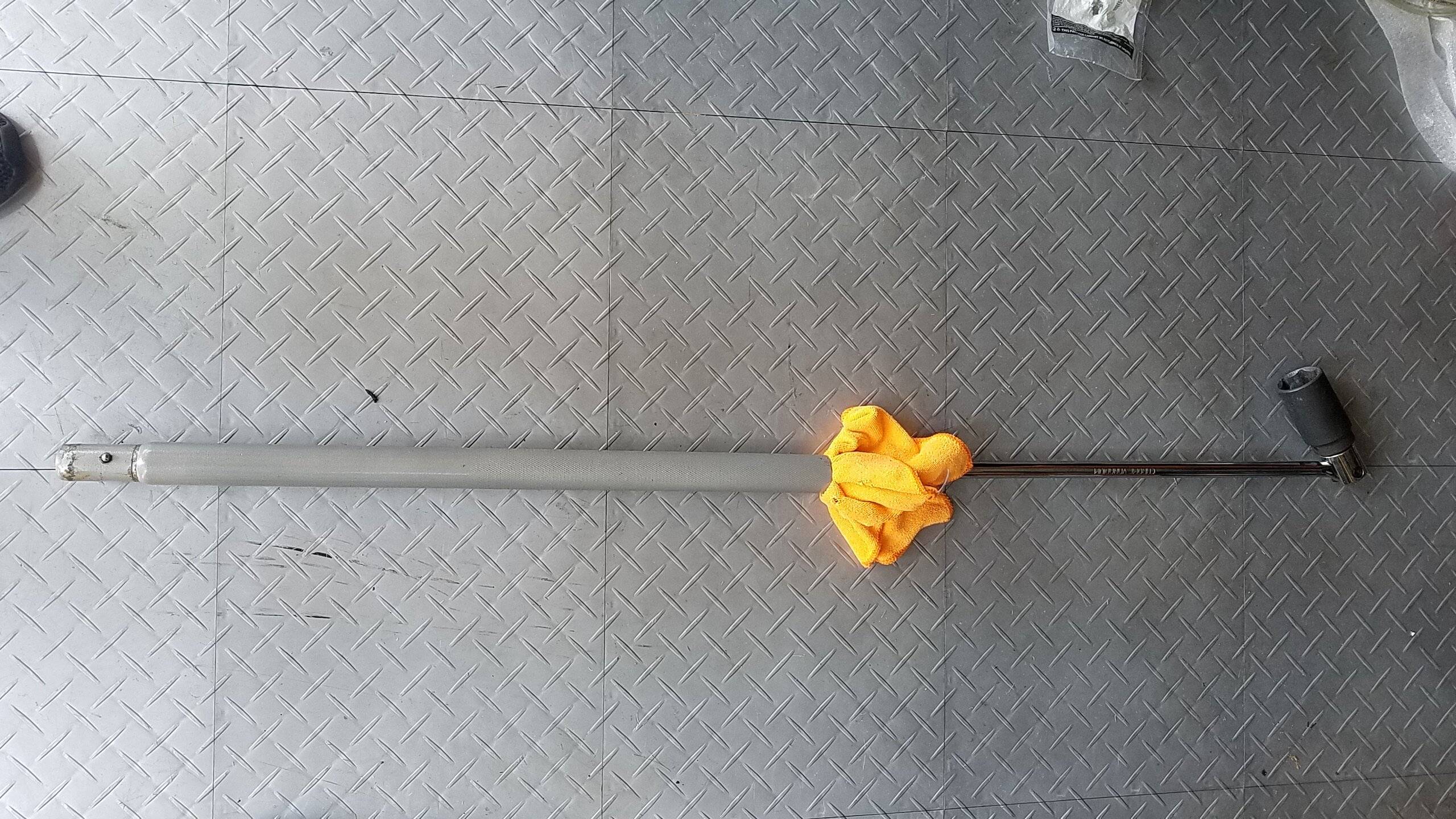

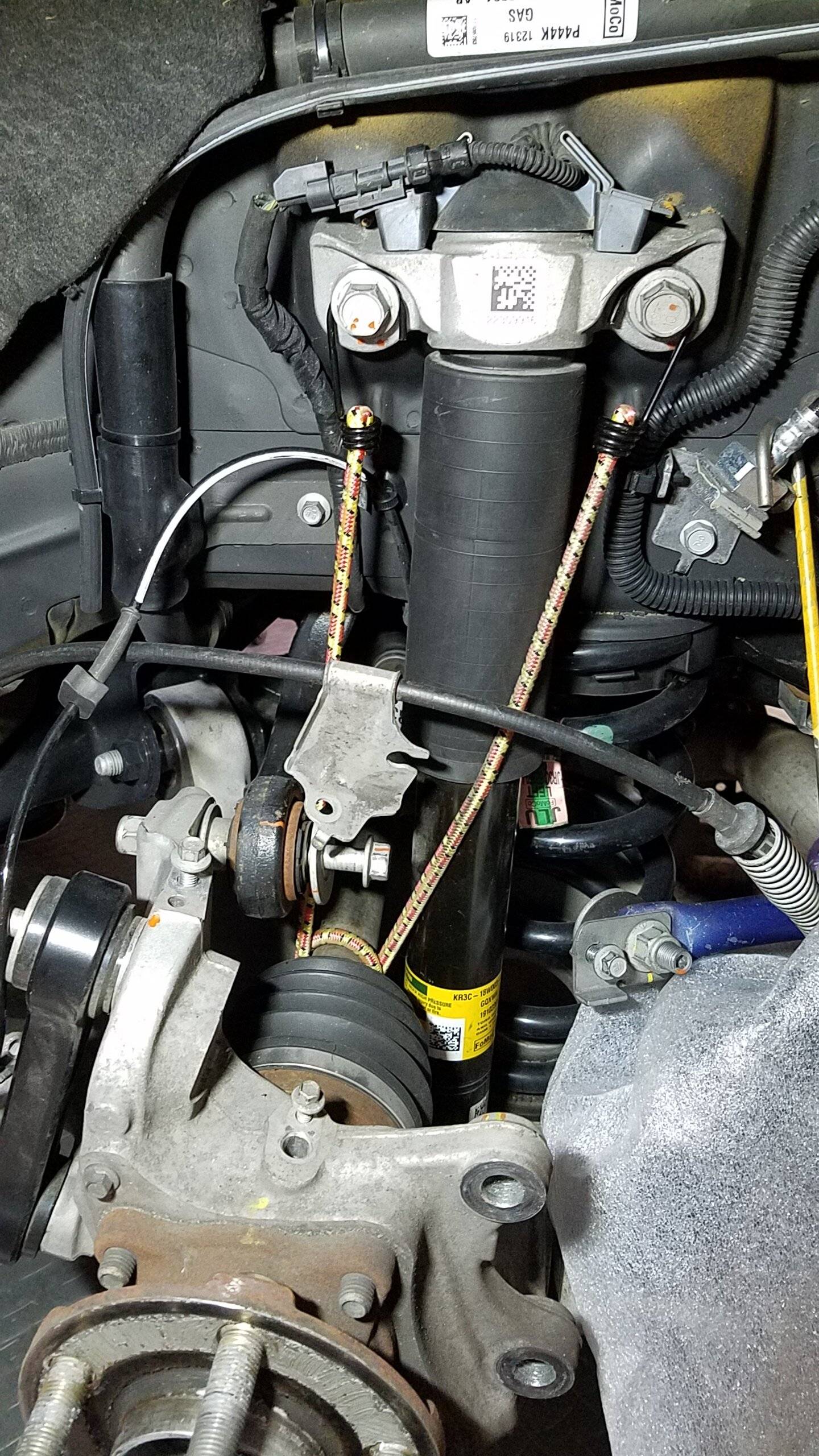

I wanted to replace my +1/2" ARP studs to +1" anyway, so I combined that with the RR hub replacement. I think I got the last 5-pack of these studs in the nation, and I am waiting for another back-ordered 5-pack. Then I will replace the LR hub. You will have an easier time with your PP car. Just hang the caliper on an S-hook. And use your jack handle on a 24" breaker bar to crack the hub nut free. (Don't forget to loosen the nut first, haha.)
On the right side, I left the knuckle intact and removed the hub by pulling the 4 bolts from the backside. Kind of a hassle, but I've done this before. Struggling with the GT350 parking brake spring didn't help either.
For the upcoming left side I am considering if I can "hinge" the knuckle downward by pulling its upper bolts. Thus giving me more direct access to the 4 hub bolts.

I used Ford OEM hubs. OP Mustang seems to be the authority on such subjects, and he says that while even the Ford could be better, no one else has a higher quality offering so far.
To add, your full description was just like mine.

This is perfect. Thank you for all the detail! I’m definitely going to try getting at the bolts without disassembling the knuckle. Next resort will be hinging it down like you mentioned.
You will find that you are using various combinations of 18mm sockets and extensions on each of the four bolts. Torque is 98# so be careful to not let the socket slip off the bolt during removing or installing.
With the knuckle intact method, you may not have to lash up your axle.
With the hinged-down method, be prepared to lash up the axle before separating it from the hub. I back out my two shock bolts enough to put bungee cord ends behind their heads. The bungee supports the axle. You can loop excess bungee around the axle until the length works out. I just bought a pair of 28" rubber tie-down straps at Walmart, hoping they are the ideal length. Won't know for sure until I tackle the left side hub.

I finally got the bearing swapped out yesterday, and it wasn't nearly the ordeal I was expecting it to be. I initially tried loosening bearing bolts without swinging the knuckle down, but I didn't have enough various combinations of extensions and universals.
Swinging the knuckle down only added a couple of minutes, and it was super easy to loosen and retorque the bolts in that orientation. Total time start to finish was 90 minutes with my son playing gopher for all of the tools and parts.
I rolled the dice on a Timken (made in China :rolleyes:, wish RockAuto noted that before buying), and so far so good. If it starts to make noise prematurely, I'll go back with a Ford part and not sweat it too much since the R&R isn't that involved.
Thanks again for all of the advice @GTP ! Car is back together and no longer sounding like a biplane!
