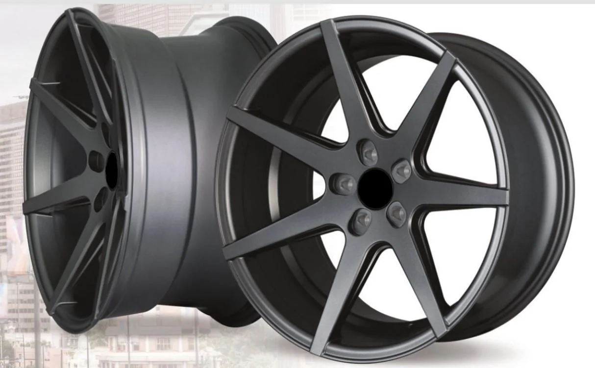

I'm looking to put these on the car, 19x11 rear 19x9.5 front.
What offset should I be looking for? The wheel comes in these options, will they work?:
19x11 +30
19x9.5 +35 or +45
I really like the concave dish on these, and they have GOT to be easier to keep clean than the PP wheels.

19x11+30 would be SUPER aggressive and you could likely only fit a 275 tire on it with significant amount of camber. 19x10.5+32 fits a 295, but requires aftermarket control arms to adjust past stock capabilities for camber.
I wouldn't recommend. Unless the 2018 has wider rear fenders and I'm just not in the know.

Check out the Project 6GR seven spoke wheels. They look at lot like those, super deep concave, but they come in perfect offsets for our cars. 11" rear, 10" fronts.

Would be a aggressive setup requiring camber.
We would recommend the Project 6GR 7-SEVEN very similar design and maximum deep concave. Direct Fitment to the S550 Mustang. (No spacers or mods needed)

The front 19x9.5 ET 35 can work, I normally do a ET 25 for a flusher fitment.
The 11 ET 30 is too aggressive and will require you to run camber and adjustments.
Normally a 11 ET 45-50 is the sweet spot
Are you after a 7 spoke or just the deep concave part of it?
