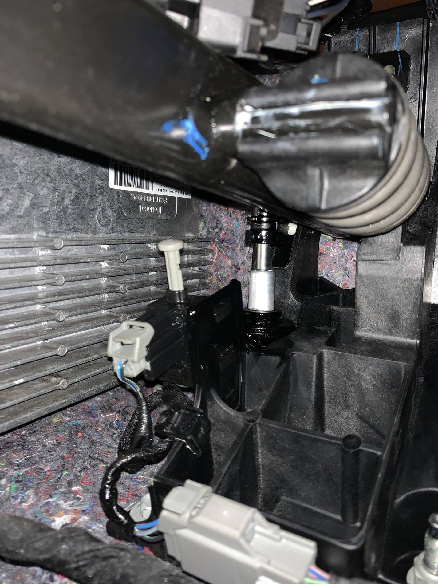

This is where the brake fluid is leaking out of

Did you change the clutch master or the brake master?
