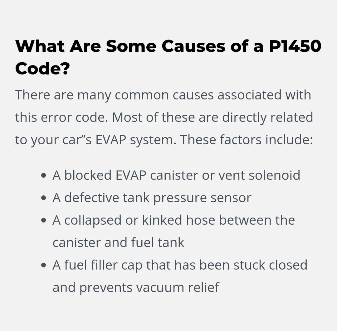

That's not exactly true. It can be caused by several things. The canister and its vent valve is certainly one. The evap purge valve (usually in the engine compartment) is another common failure along with several other things.
P1450 simply (or not so) refers to the system detecting excessive vacuum in the fuel tank.
