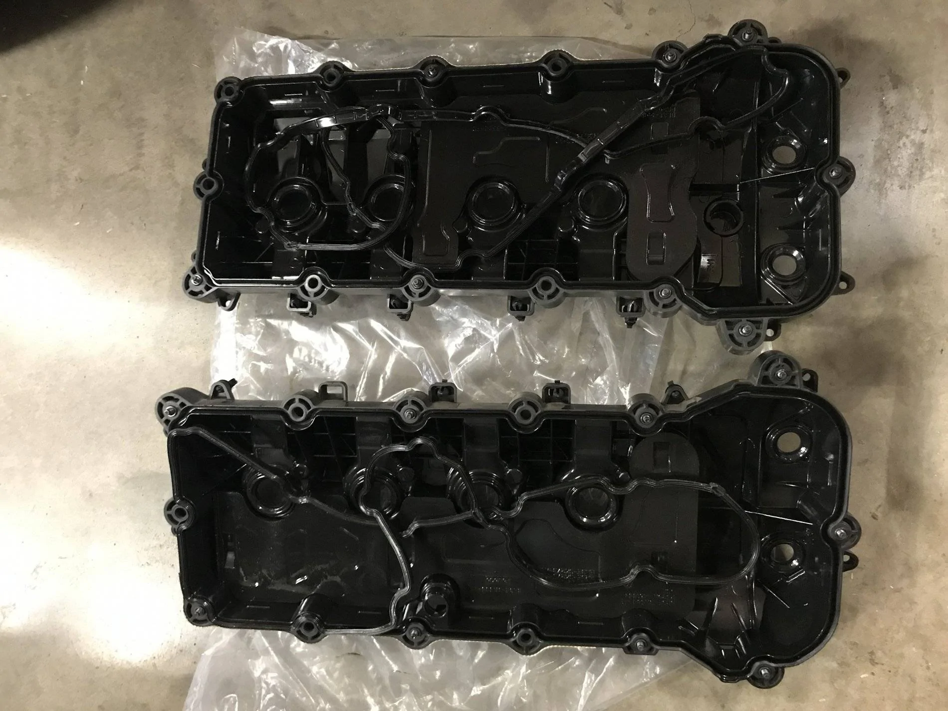

@thelostotter do you have pics of the stock valve covers? Did the driver look like mine? How did the passenger side look?

thought it was interesting that they are held onto the head with about twice as many bolts as the stock covers.
So does that mean that about half the holes on the new covers are don't line up with anything on the stock head and are just left empty?
They look just like yours. The GT500 passenger side cover follows the same path as the stock cover. Driver side on the bottom in the pic.
The GT500 covers use all 14 bolts per side; the head is drilled and tapped at all locations. You can see in the pictures below which holes in the stock covers do not have bolts installed. Some of the spots missing bolts aren't even drilled to accept a bolt.
The heads (and timing cover) are drilled and tapped for all 14 of them.

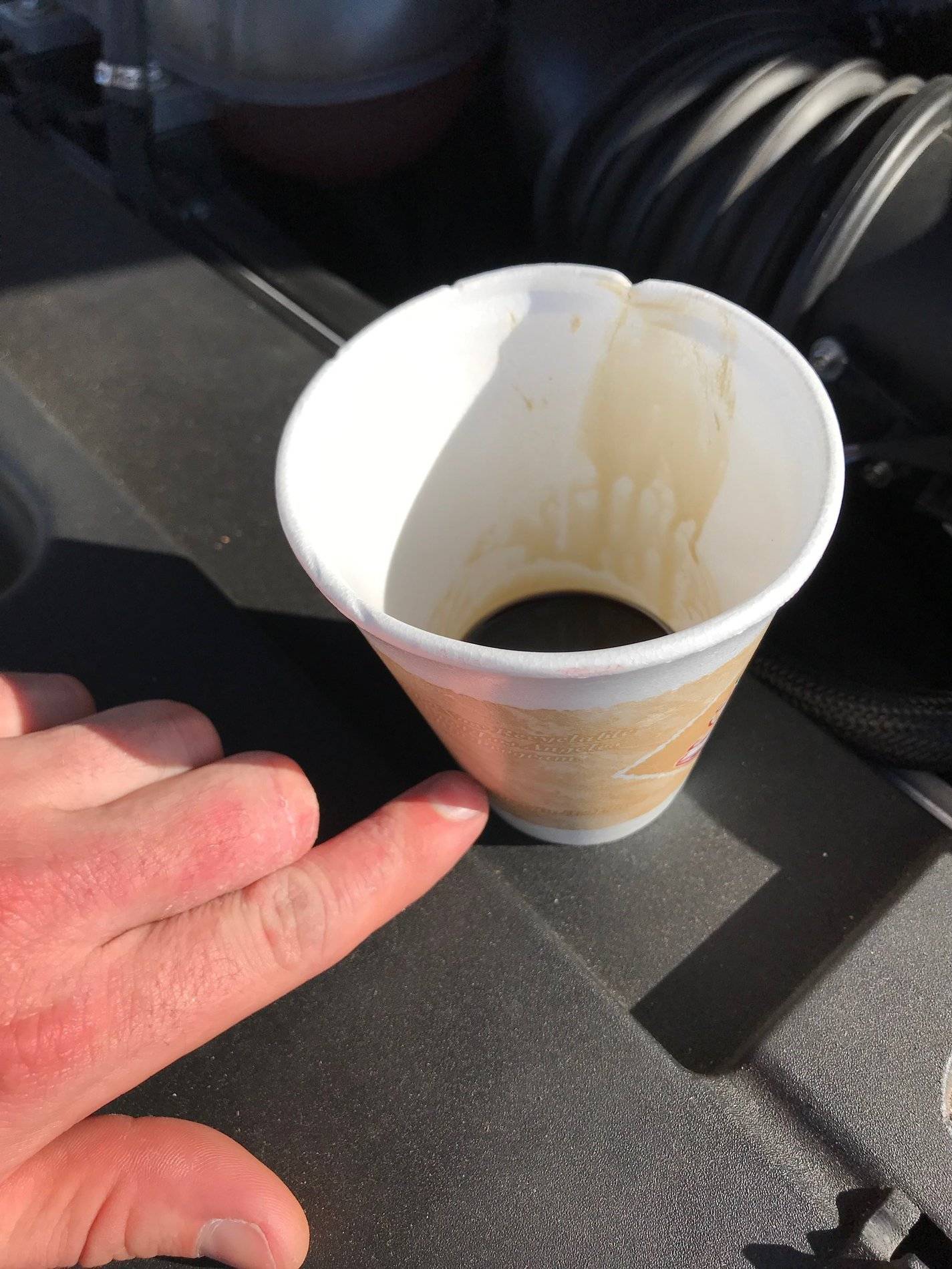

Ran at the same track today that gave me issues in December. These GT500 valve covers solved the issue for me. I also put on a driver side catch can at the same time which caught about 1 oz of oil total today after four 20 minute sessions. Zero smoke. Passenger side can caught <0.25 oz, barely enough to cover the bottom of my cup, and this also includes about 500 miles of daily driving since I emptied it last.
Driver side can contents at the end of the day:

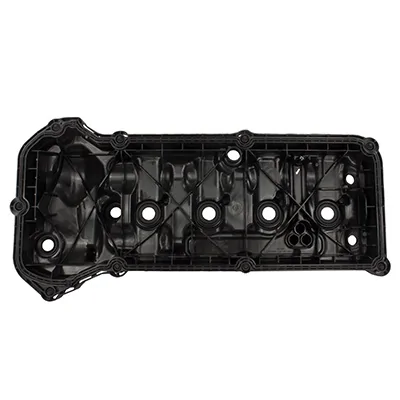

Is this issue not applicable to 2018+s?
I guess this is what 18+ look like https://www.oemfordpart.com/oem-parts/ford-valve-cover-jr3z6582b
