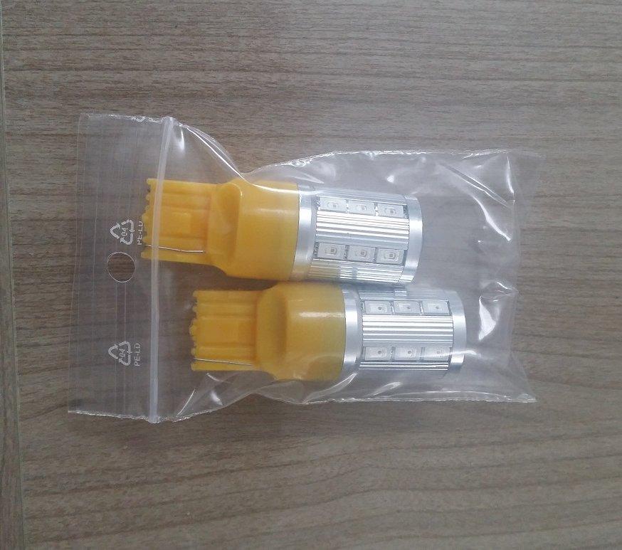

Anybody know if these will work for the front turn signals? http://www.hids-direct.co.uk/585-wy21w-amber-60w-cree-xbd-smd-12-5w-canbus-led-indicator-bulb/
I also noticed you say our front headlight bulbs are D8S yet in my owners manual it states they are D3S, which you swapped to?
That's the LED bulbs I have on my car, so seems really close to what you found. But they don't stay in the socket, I needed to put some "patafix" so the bulb stays in the socket.
And yes, on the car we have D8S bulb + ballast. For that point I swapped them to the D3S model.
Ok I will bear that in mind when I come to order the LEDs. With these do I need the resistors in series to sort out the fast flashing/blinking problem? If so, it might be worth adding that link to the first page please :)

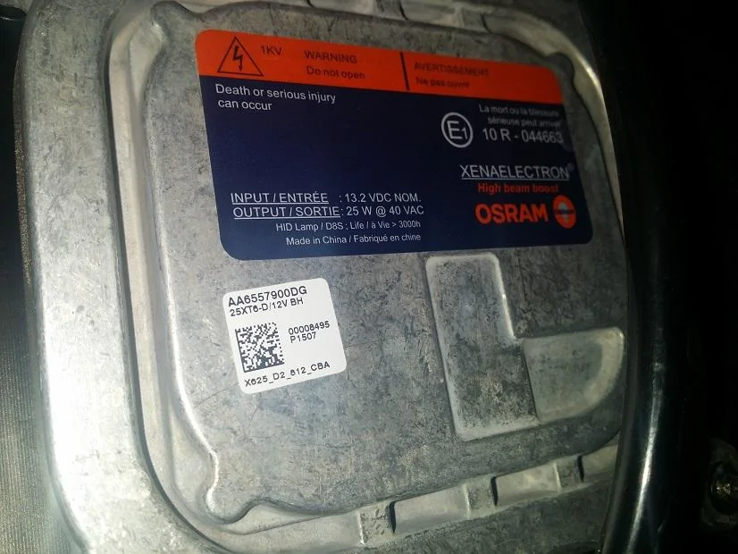

Where are the ballasts located so I can double that I do in fact have the D8S version installed?
You definitely need the resistors to sort out the fast blinking problem.
Thanks for the tip, I added link to first post :thumbsup:
It's difficult to access and to find the info. You can try to take a picture with your phone of the back of the light and you will see the ballast.
Then you will find the version on it, IMO you have also a D8S model.

I have em from DD, no issue with the socket fit well. The only thing is the hyperflashing on the dash. Either you need a resistor or LED turn signal flasher.

[MENTION=12964]Stark[/MENTION] , here's a picture I found in my phone showing the model of our D8S ballast :
Did you try to see if you have the same model ?
Thanks mate and no I haven't had a chance yet but will do when I can.
