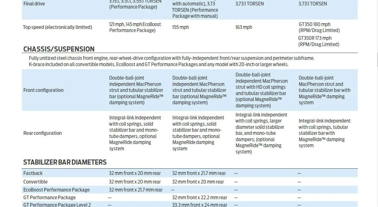

Check out the line below the Chassis/Suspension heading. Based on that I am assuming Ford considers 20" wheels to be an addition to performance. Base models with smaller rims do not get the K Brace, whatever that is.
This screen grab is from the 2019 Mustang spec chart.
Norm Peterson
corner barstool sitter
Jul 22, 2013
8,852
4,652
Norm
'08 GT #85, '19 WRX
That's not exactly what the note says.
Being included with 20" and larger wheels is not the same thing as being included with them because the 20-inchers were chosen for performance. Claiming to have better performance than base (235/50-18?) isn't saying much at all.
Chances are it was more for NVH and cowl shake reasons, since 20" packages do tend to generate more NVH.
