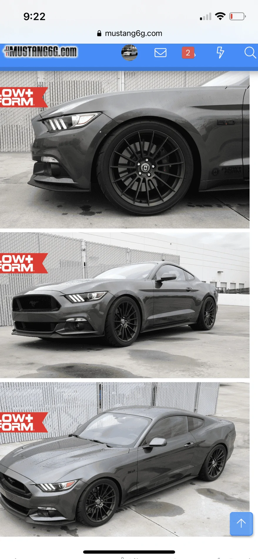

Looking at these wheels - really easy to maintain a squared rotatable setup.

Guess I wasn’t paying attention to the wheel quality, it’s mostly street - mainly freeway, so no abuse. Those are the styles/types I’m trying to accomplish.
I believe MMR and ACE have a similar design but I didn’t think ACE had black as a color option, and since the track wheels are gray, I’m looking for black.

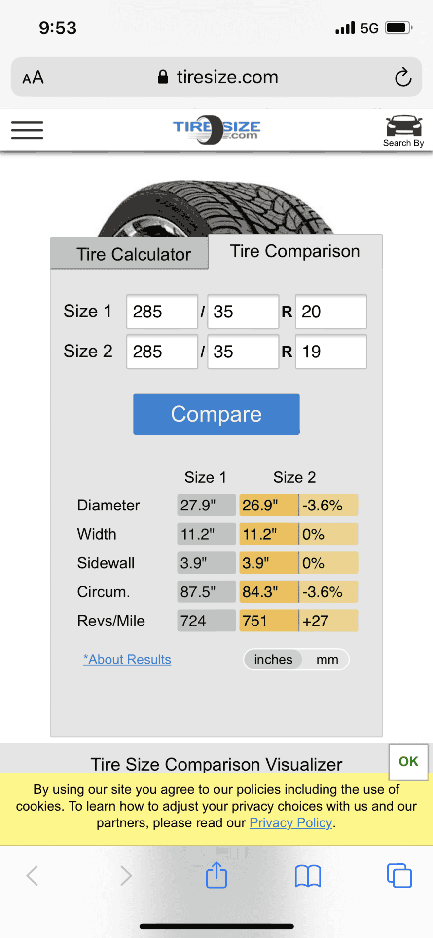

Thanks on confirming 285/35/20 - looked to be about an inch bigger than my current setup so was concerned a tad.
27.9” overall is okay right? I’d rather fill my fender to wheel gap, so I like the idea of larger overall diameter.
285/35-20 would also be close to the diameter of the 275/40-19 rear tires that are part of the PP1 package.

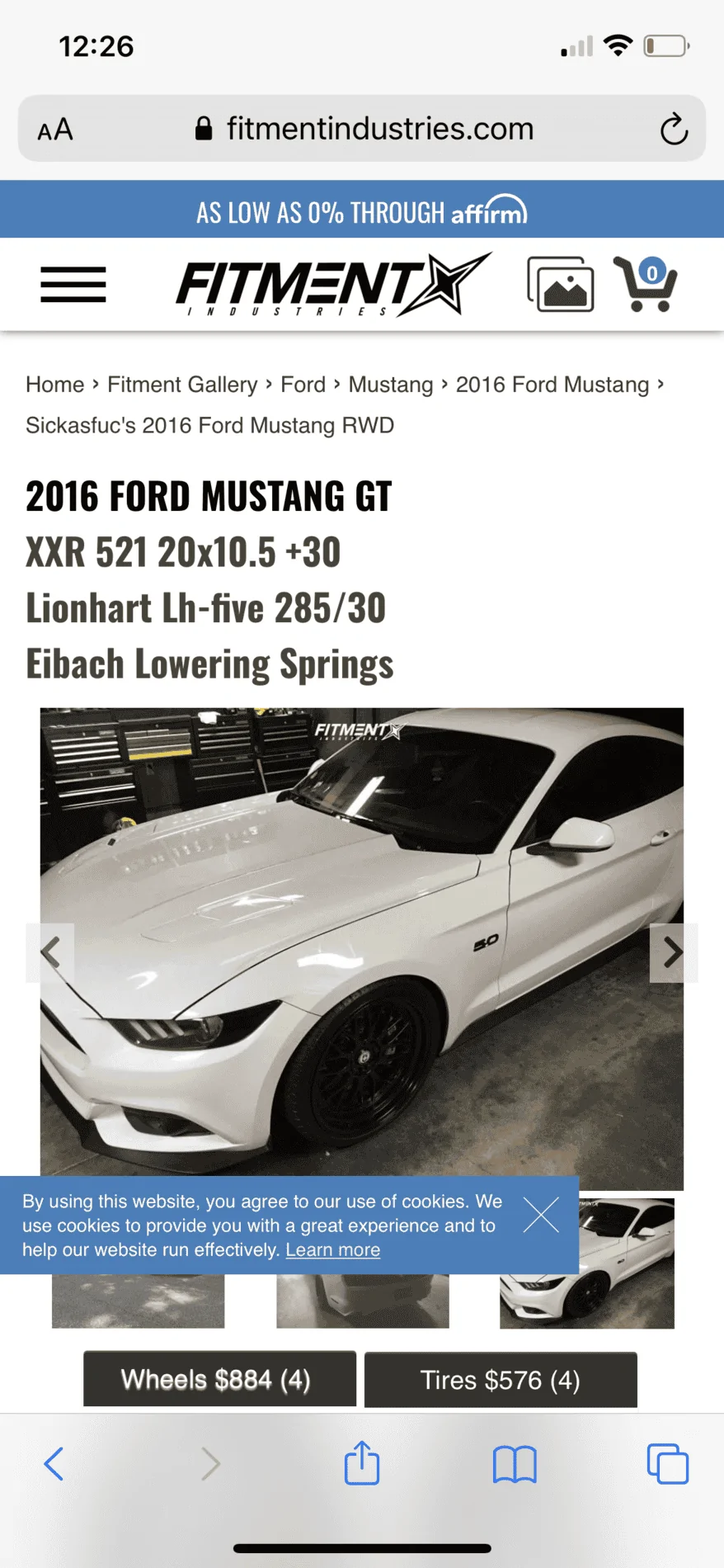

305/30/20 fit on 20x10’s - any rubbing?
Spacers needed in front?
No, sorry. I had the 305's on the 10.5" wheels. They would probably squeeze onto a 10" wheel, but would have lots of bulge, and not be nearly as effective.
The wheels I had were 20x10.5 with spacer the effective offset was ~ +17 (probably too much, but I wanted to have more clearance inboard to not rub the strut). Even so, they still rubbed a bit on the outside fender under full compression.

How much do these wheels weight?
Given these prices, I would just get stronger and lighter SVE wheels.
20x10.5 +30 would be pretty pokey on the rear, combine that with taller tires and you are in danger of rubbing or worse.

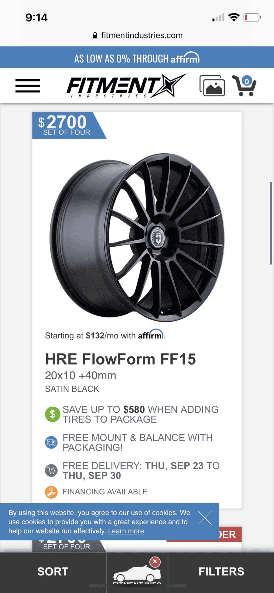

Spending that much $$$, I might as well go for exactly what I want - the HRE FF15’s
I’m basically looking for a budget set of these LOL
