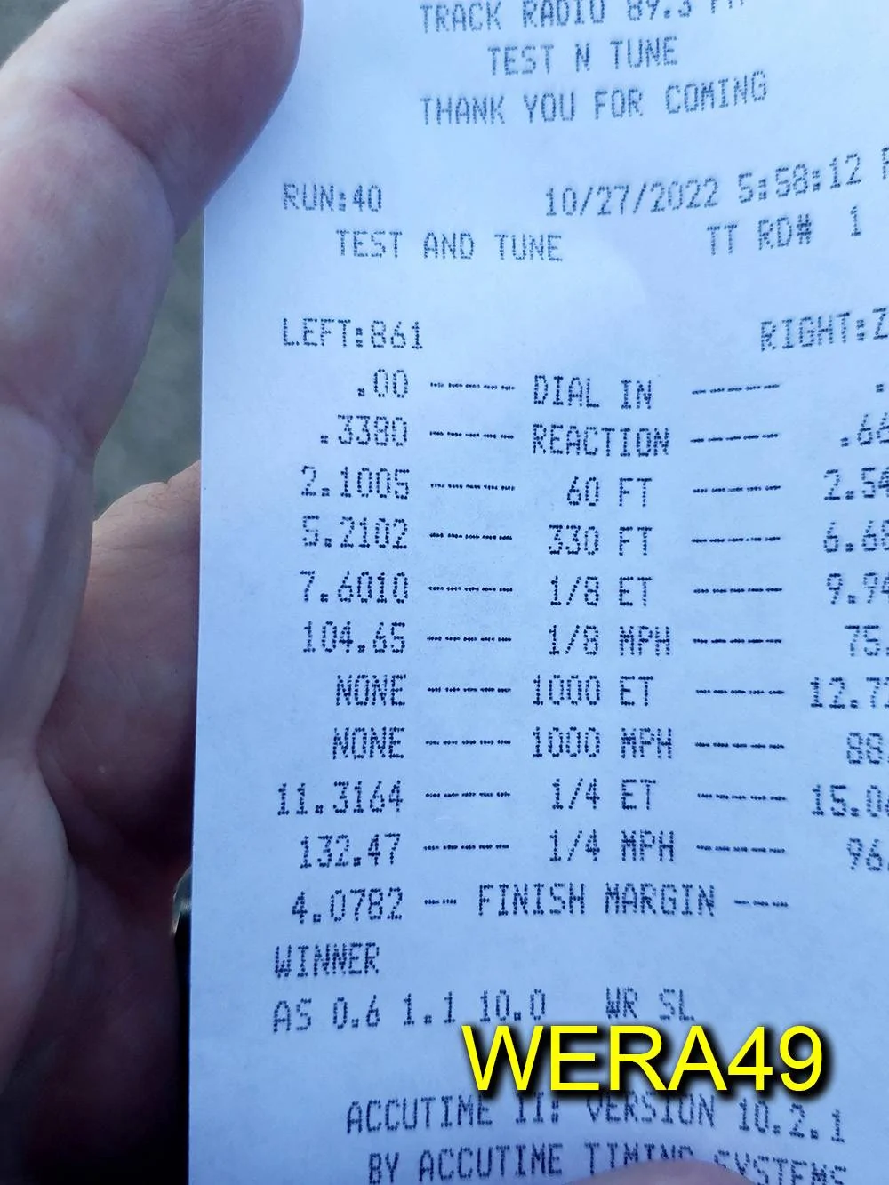

After having my Mustang for four days, I took it to a dragstrip on the way home. I'm still learning the car. It is very different from the German cars I've been driving for the last eight years.
Specs:
Roush Supercharger
10R80
3.15 Gear
Continental 20" tires
500 Treadwear Rating
32 PSI
I left at idle and still had wheelspin.
What is a realistic 60 ft. time for this car with Steed subframe connectors and drag radials? I just want it in the 10's.

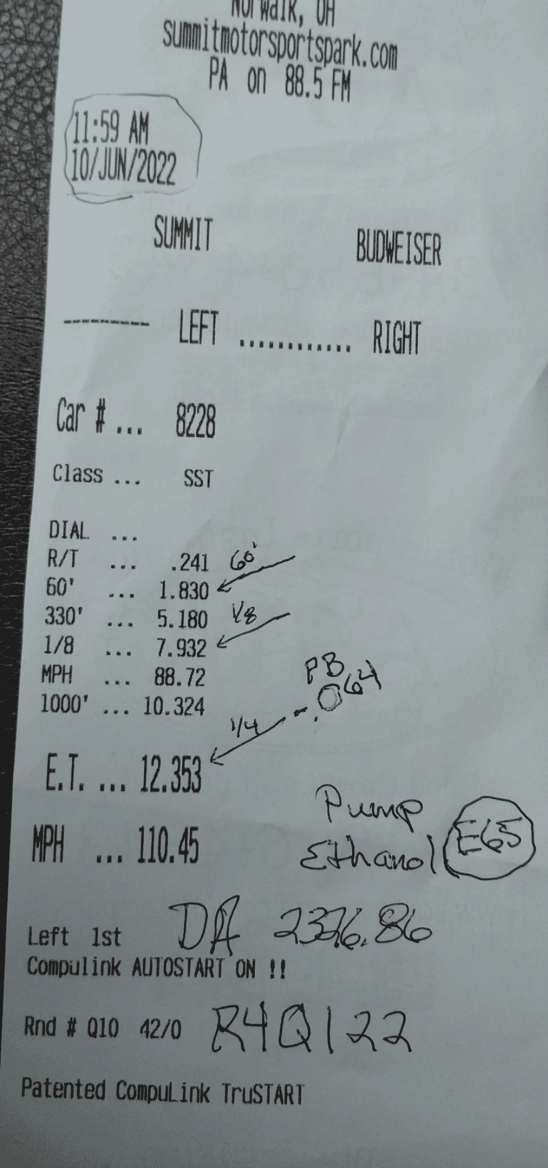

My 1/4 mile ET is a full second slower than yours. But my 60' is 3/10 quicker. Off the line I have zero wheel spin and no wheel hope.
I agree and recommend, a good set of drag radials and plenty of seat time!
Enjoy, be safe.

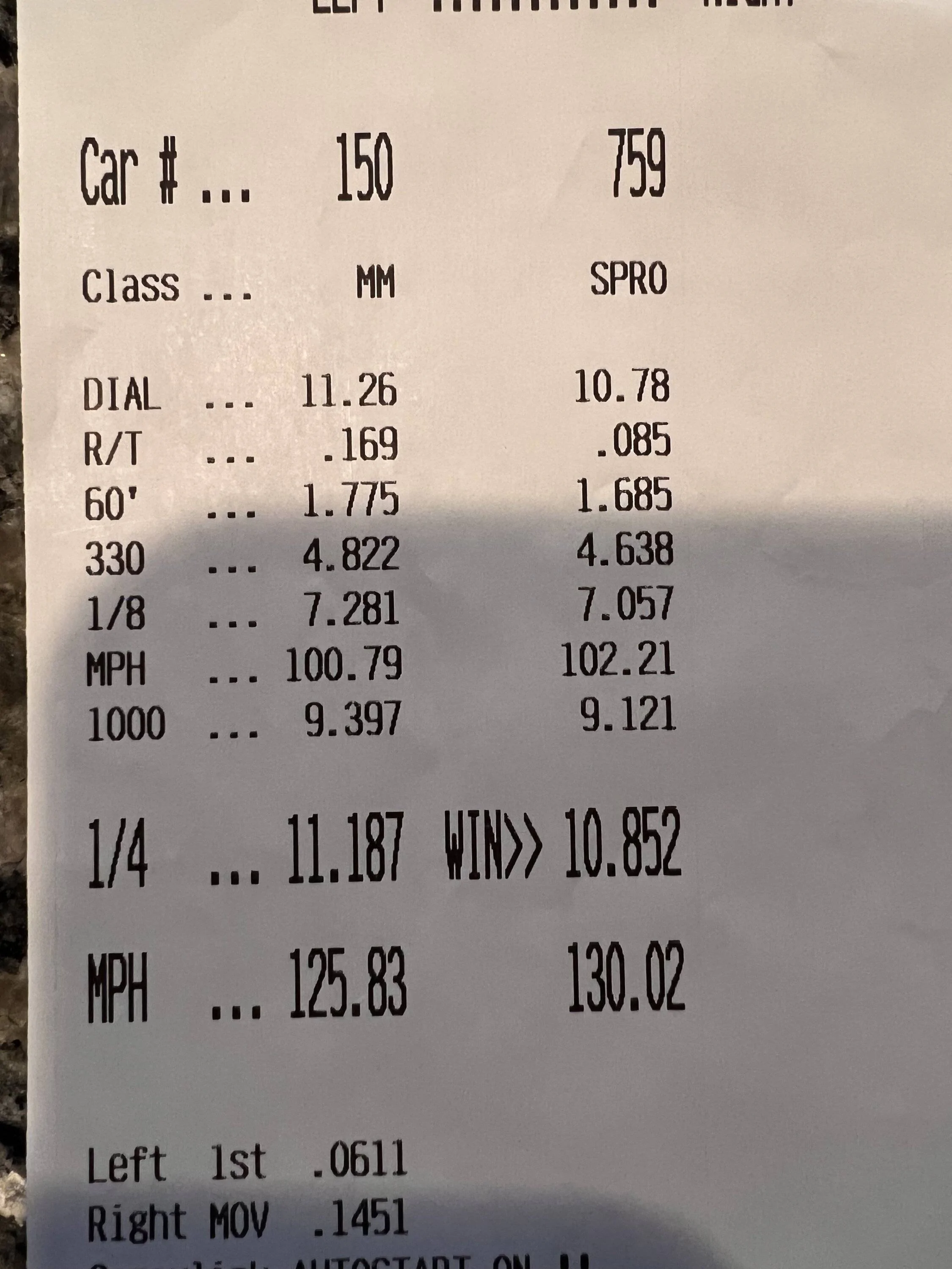

This is launching at idle. E85 car with 3.55 and ET Street R’s 305/45R17’s. Get yourself of drag radials and start making passes. 60’ 1.77 11.18 @125
