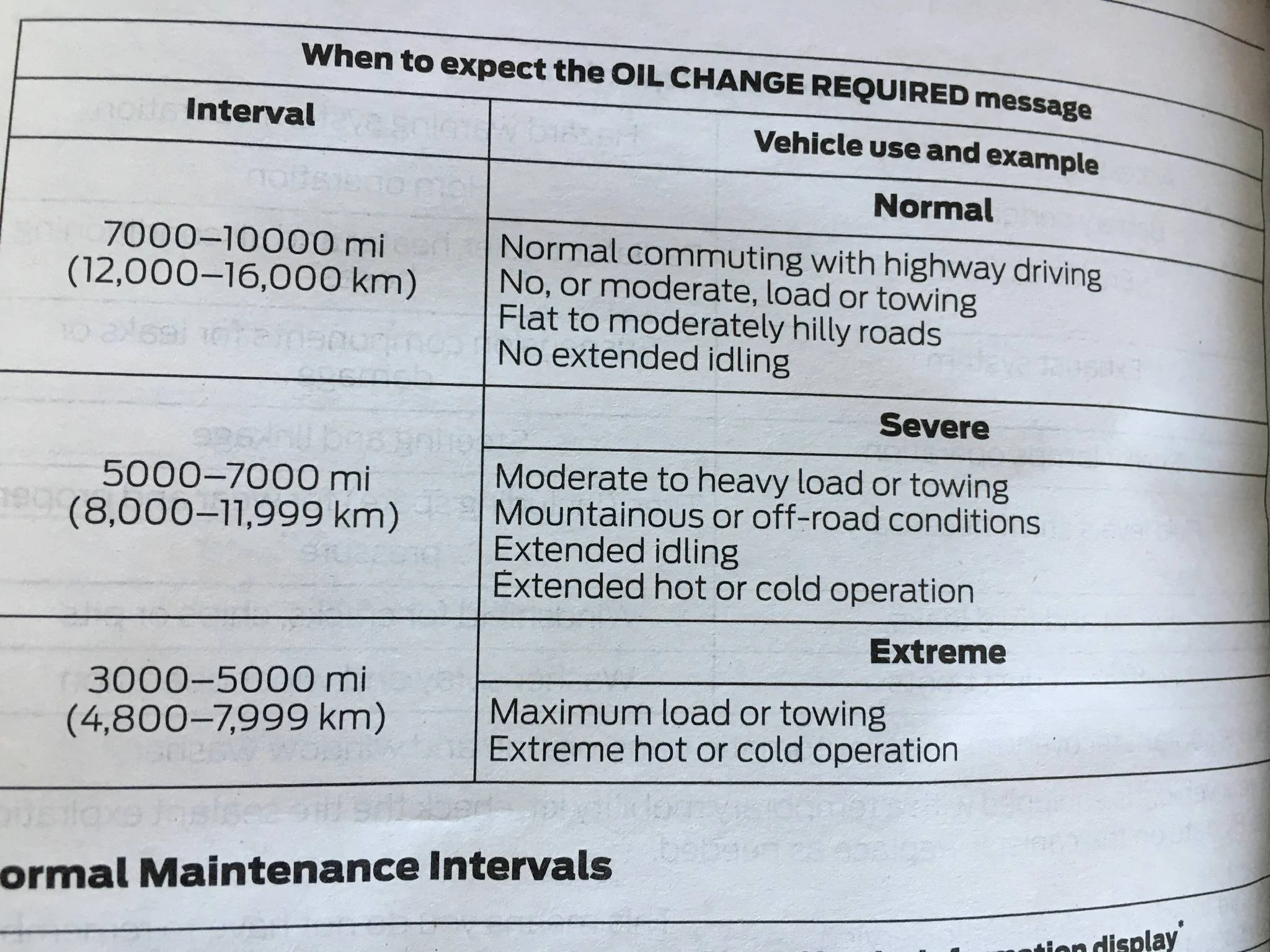

It can come on anytime between 3-10k depending on driving , there is a section in your handbook do not just reset it change it , I have averaged 6k miles between changes over the last 5 years
