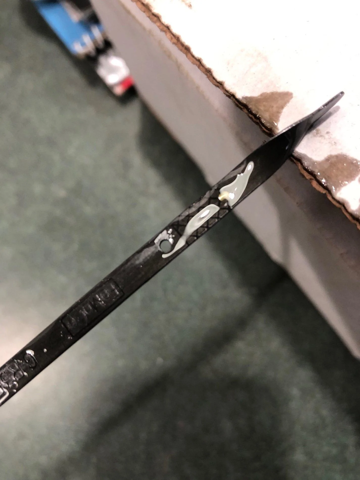

thanks for some good tips for oil change. Had the opportunity today to get the 350 off of the stands & out on the road after the winter hibernation. Fresh oil change & decided to take a pic of the dipstick for future reference as time moves on. Going to log miles & see if Voodoo likes the taste of oil!
