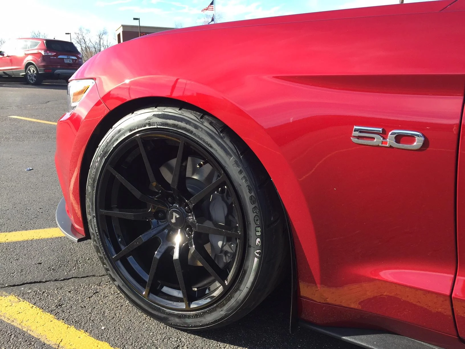

19x10 , 40mm offset with a 285/35/19 and no spacer. Should work with a 42mm offset

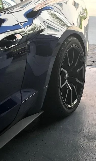

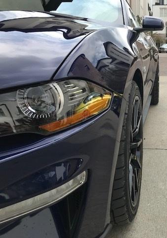

19x10 +40 with 285/35/19. I like the tire flush with the body and that is what this gives you. Just like the pic above with the same set up.
No spacers.
Rear is 19x11 +50 with 305/35/19.

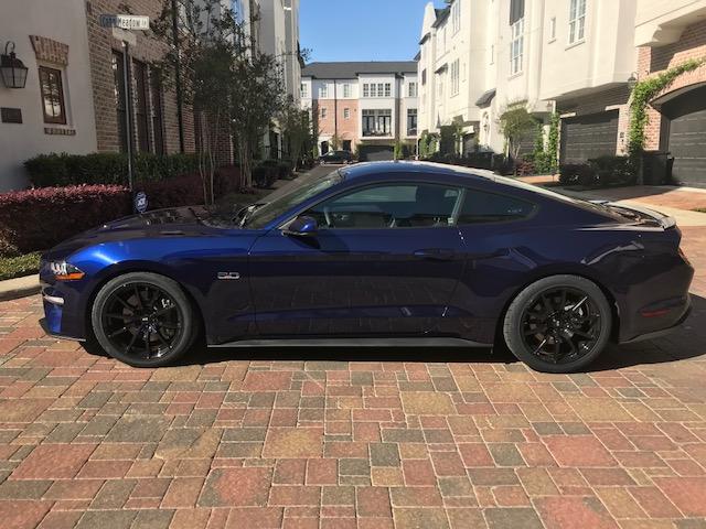

No spacers.
Have you got a side shot?

I think the shadows make it hard to see the wheel gap. I need to get a better side pic.
