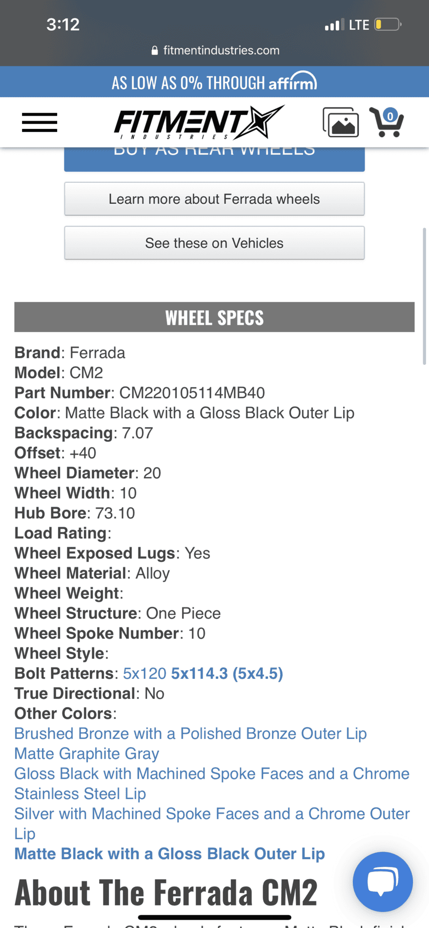

I have been catching hell trying to find black rims for my 2018 Mustang GT PP1. The brembos make trying to get a full TRUE square setup hell. I want to be able to rotate my tires. I am going to run 285/35/20 tires. I didn’t want to use spacers, but at this point I don’t care.
SO my question: will I be able to get 20x10 farrada CM2 rims +40 offset ALL AROUND and put some type of spacers at the front to clear the brembos and have an overall flush or at least not a pokey setup? With no issues?This was the best I could think of...
