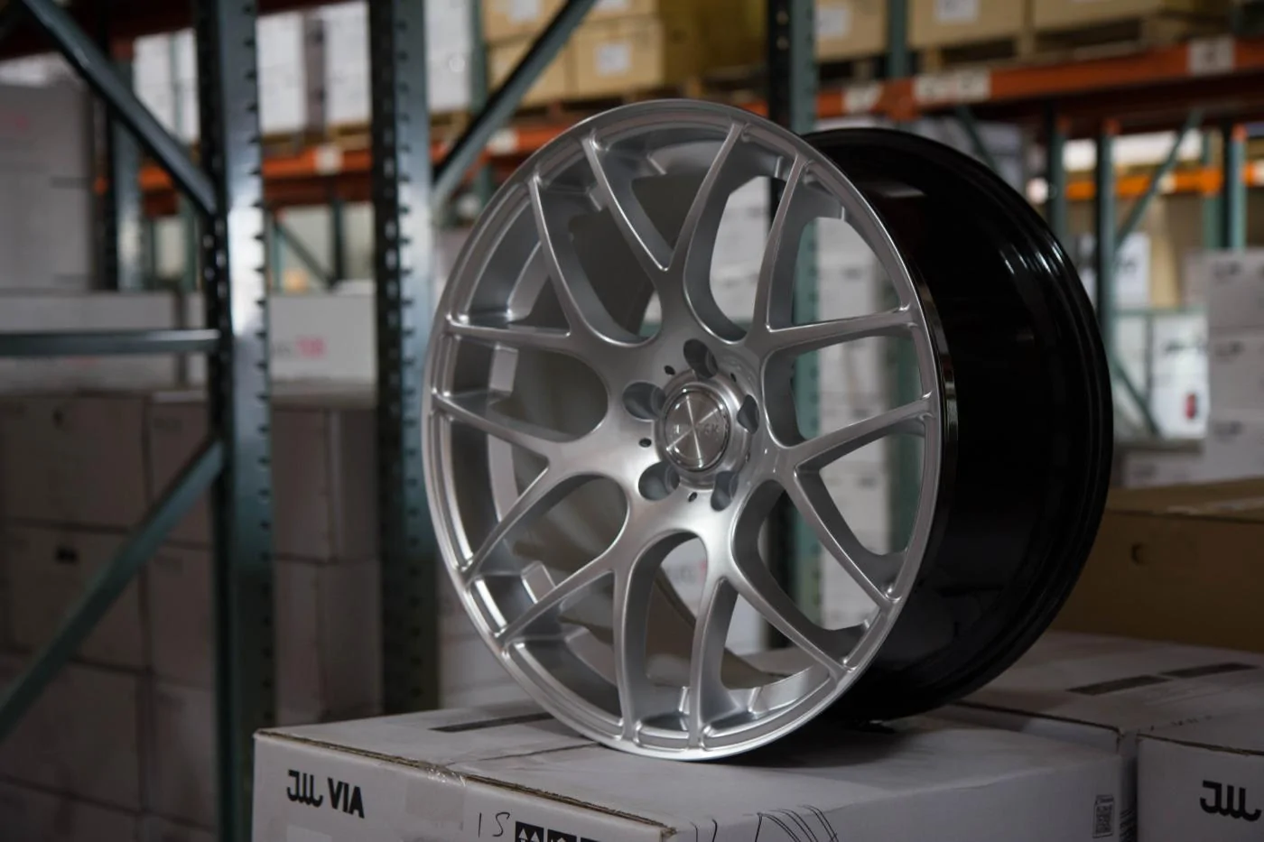

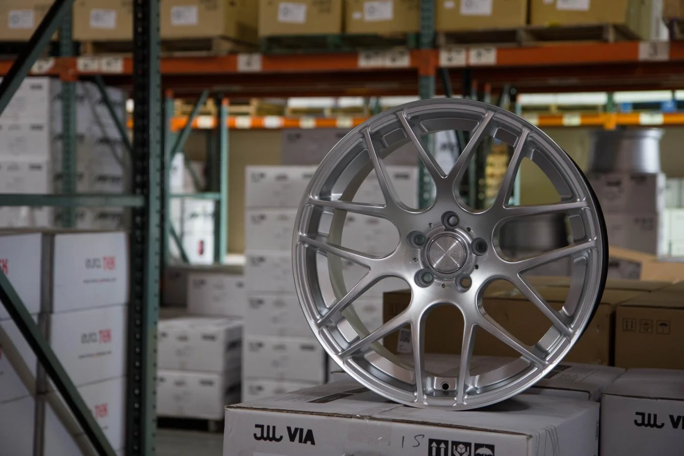

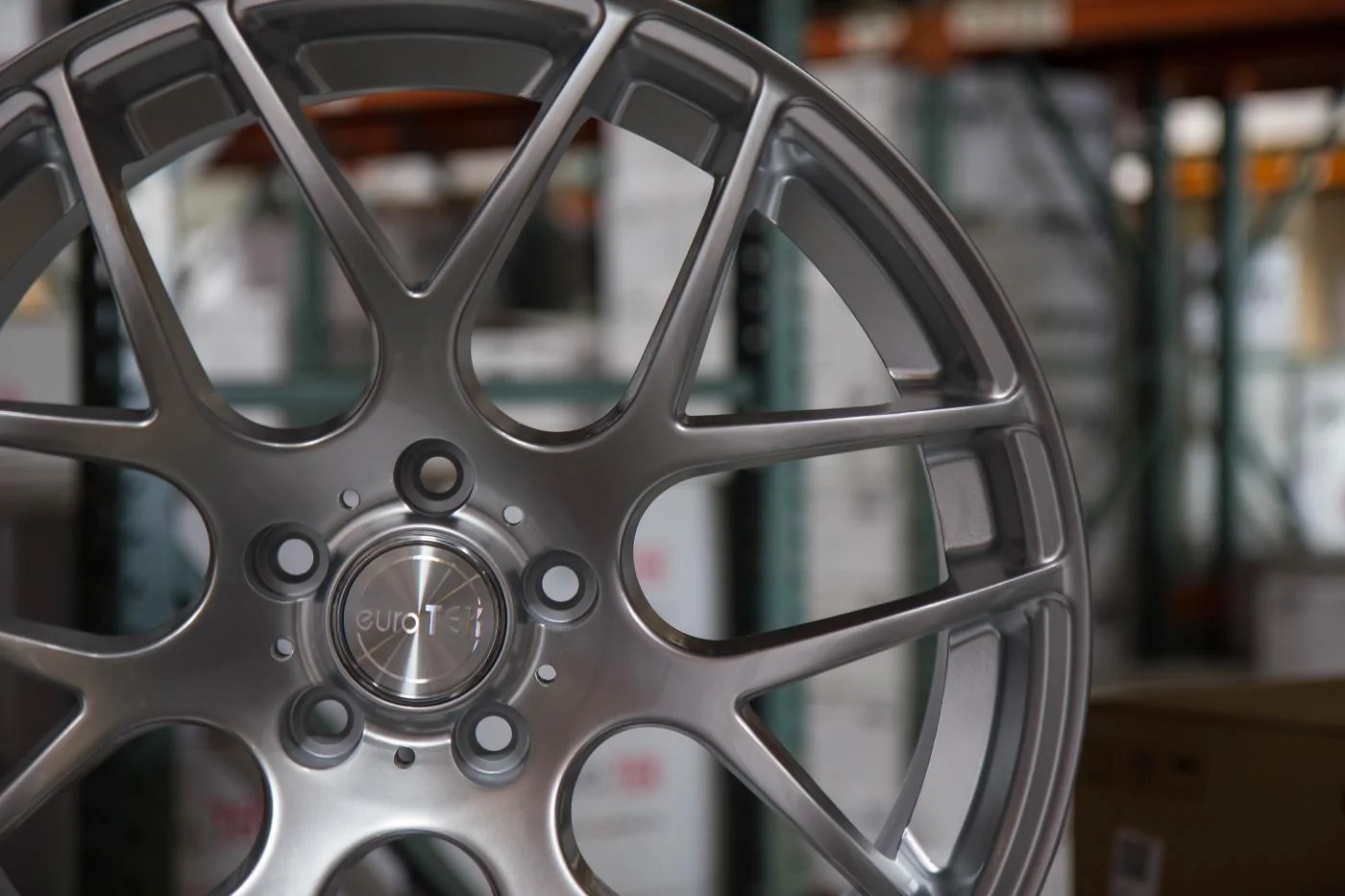

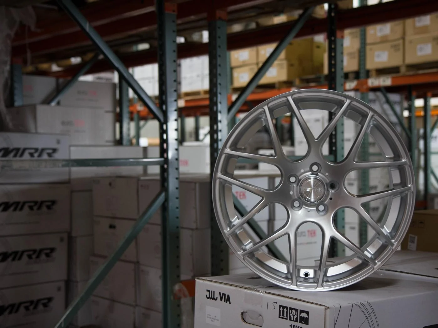

UO02 eurotek by MRR Design Wheels
Ive notice there are a good amount of members who are just looking for a simple set up that will look great yet wont dry up your savings account, i never mentioned this before but we do have a very popular wheel under our Eurotek Brand, it is a low pressure cast wheel, 100% backed up by MRR Design wheels under our Life time structure warranty and comes in two standard finishes. also the price is right on point even if you decided to get a custom finish. here is the info feel free to pass along.
weights are standard at 27lb fronts and 28lb rears concavity is ok nothing crazy ( like i said is for a quick intro to a great set of wheels)
Wheel Brand: EuroTek by MRR Wheels
Wheel model: UO02 ( Mesh )
Finish Available: Hyper Silver and Matte Black
Size and specs: 19x8.5 5x114.3 35et and 19x9.5 5x114.3 40et
Yes the 19x9.5 can be used for square set up's
4 wheels +install kit + hub ring + MRR Sticker + Shipped to anywhere in the main land 48 states is only $225.00 each wheel
Custom Color options: only $100.00 each wheel
colors available : Gloss Black, Sports Bronze, Gloss Graphite, Matte graphite
even with custom finish your at about $1300 shipped.
Keep your factory tires and TPMS an you have a bad ass stang with plenty of money in the bank.
just figured i shoot that over, who has this deal??? Contact Paul at Need 4 Speed
1-888-714-7467.
