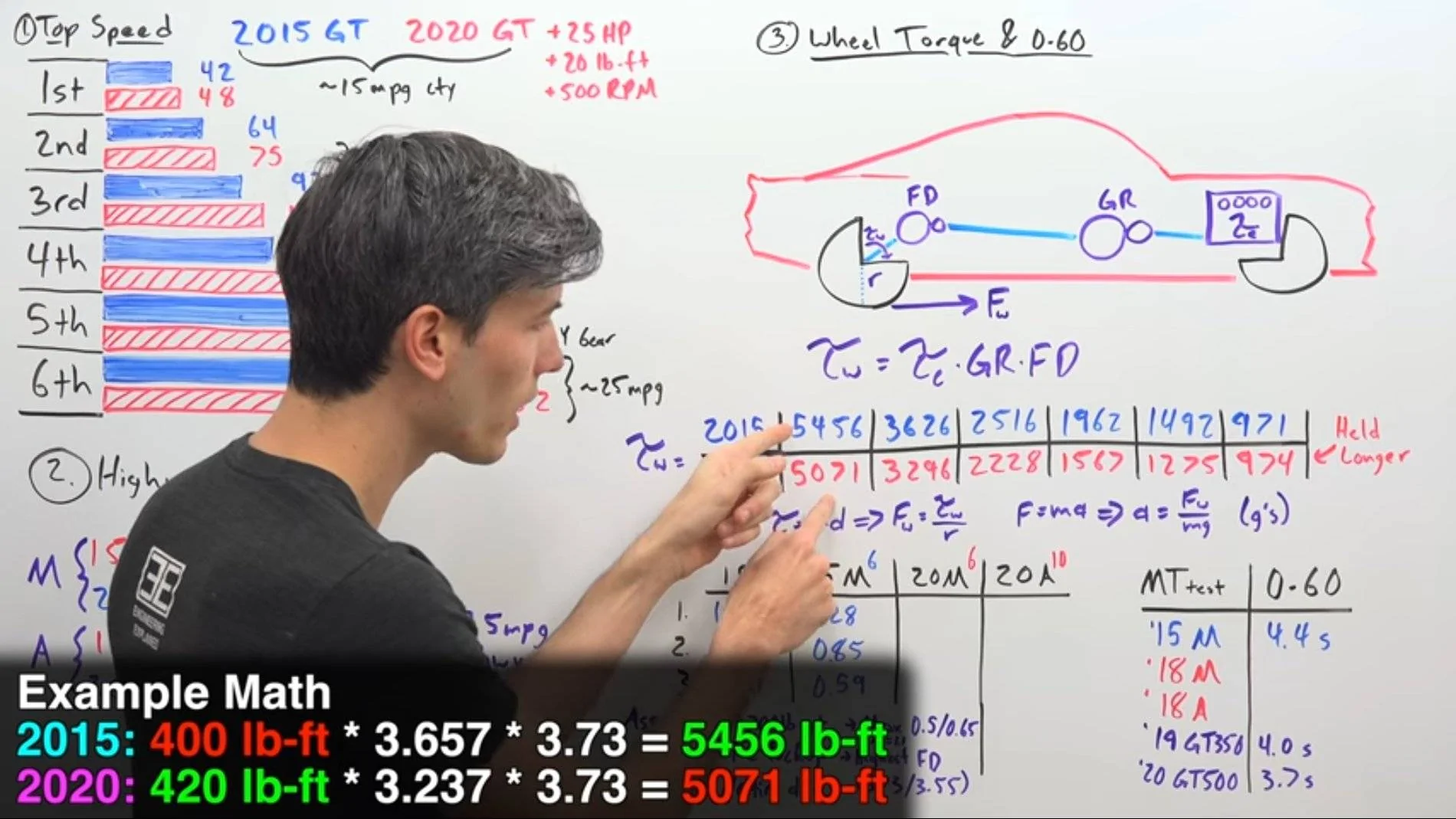

Copying the engineering explained math, you have 3.55 gears on the nonpp.
3.55x3.237x420=4826 ft-lb
3.55x3.237x445=5113 ft-lb(445 is what ford and other tuners are getting with 91/93)
4.09x3.237x420=5560 ft-lb
You'd need to get to 480+ hp with 3.55 gears to get the same torque that 4.09 gears and stock tune.
3.55x3.237x484=5561 ft-lb
If you have 3.73 obviously the "gains" would be different.
