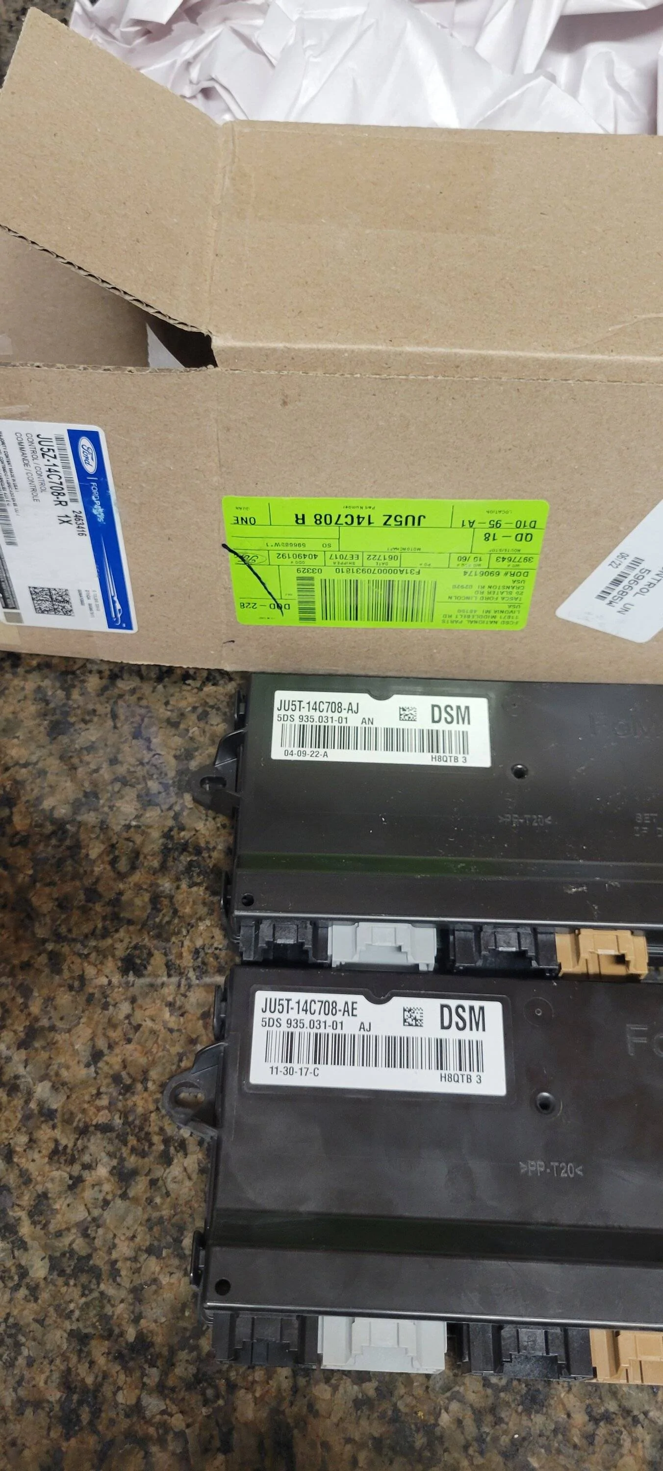

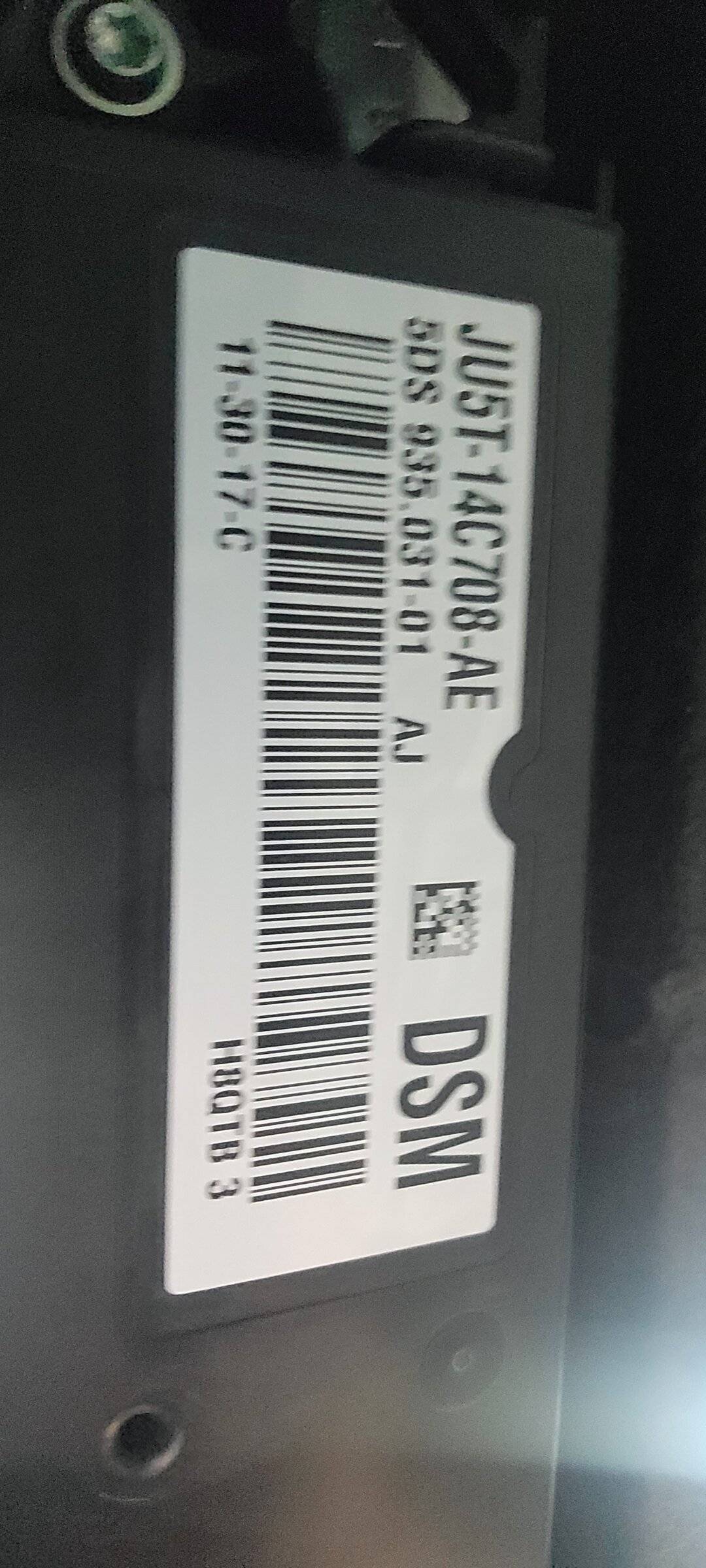

I appreciate the link, but that's a 2017, and doesn't sound like my issue. I'm thinking it's the module under the seat (pictured) .
The seat had been working since getting the car about 2yrs ago. Can't find any used ones, and there is a new SKU- for that part (JU5Z-14C708-R)
There is a thread with the same issue, but no updates for long time about a fix. The new part is about $200 with shipping& tax. Or $350 from dealer.

Update- Ok, so I final got the replacement control mod in and replaced it. Simple enough to disconnect and connect the new one and didn't seem to do anything at all.
The lights come on still, but no sound, or click like others have had. So unless I can figure something out, looks like it's going to the dealership.
