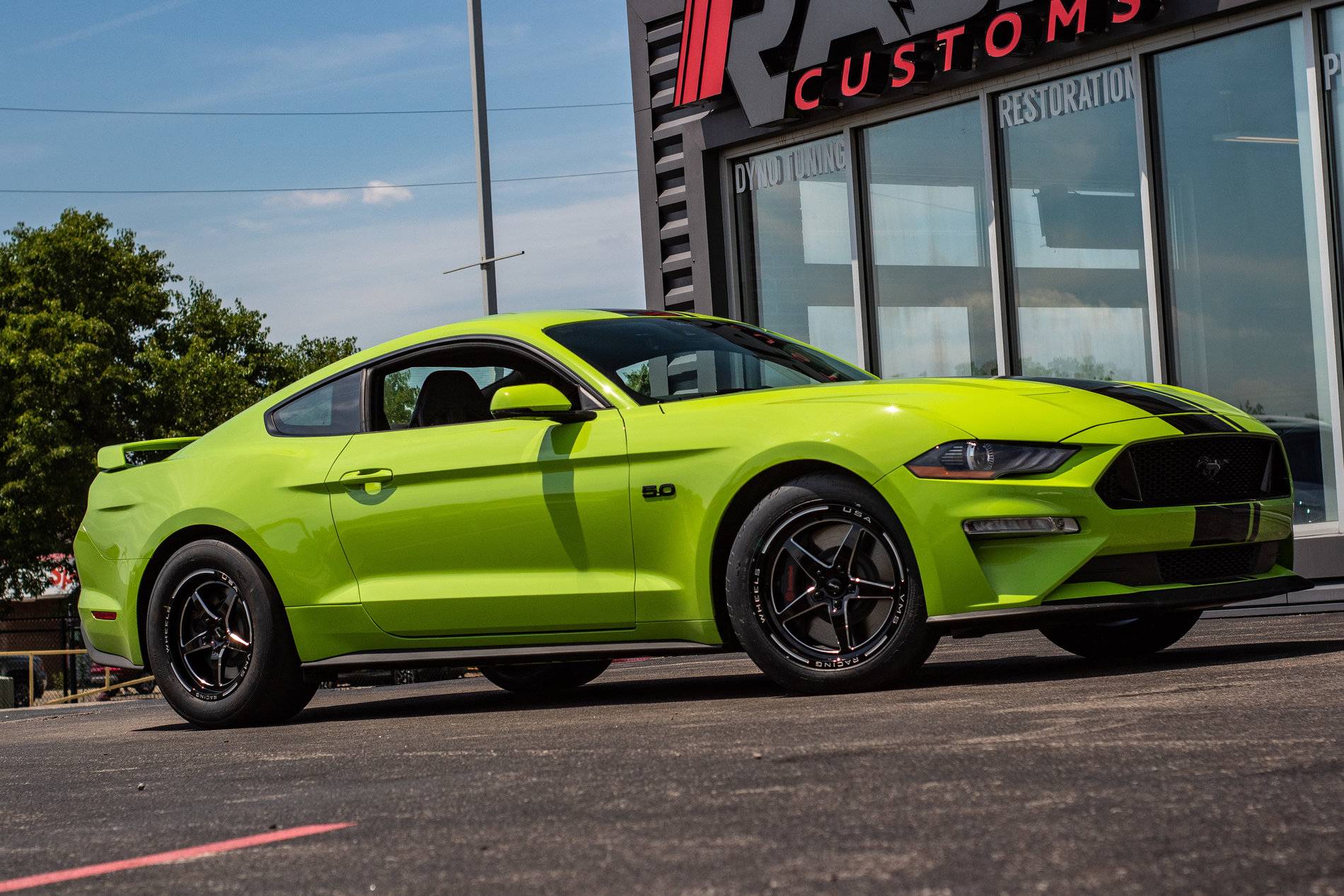

I own a 20 401A PP1 A10 car w/Active exhaust. It has a Roush X-Pipe, but IMO its not enough. I feel like I've looked at 100 different options when it comes to exhaust. What has anyone used that they're satisfied with that doesn't completely irritate their neighbors in quite mode during cold start.(not my biggest concern, BUT).
***note i do not plan on doing headers as with in 1-2 years i will be going single/twin turbo***
pic attached of my ride
