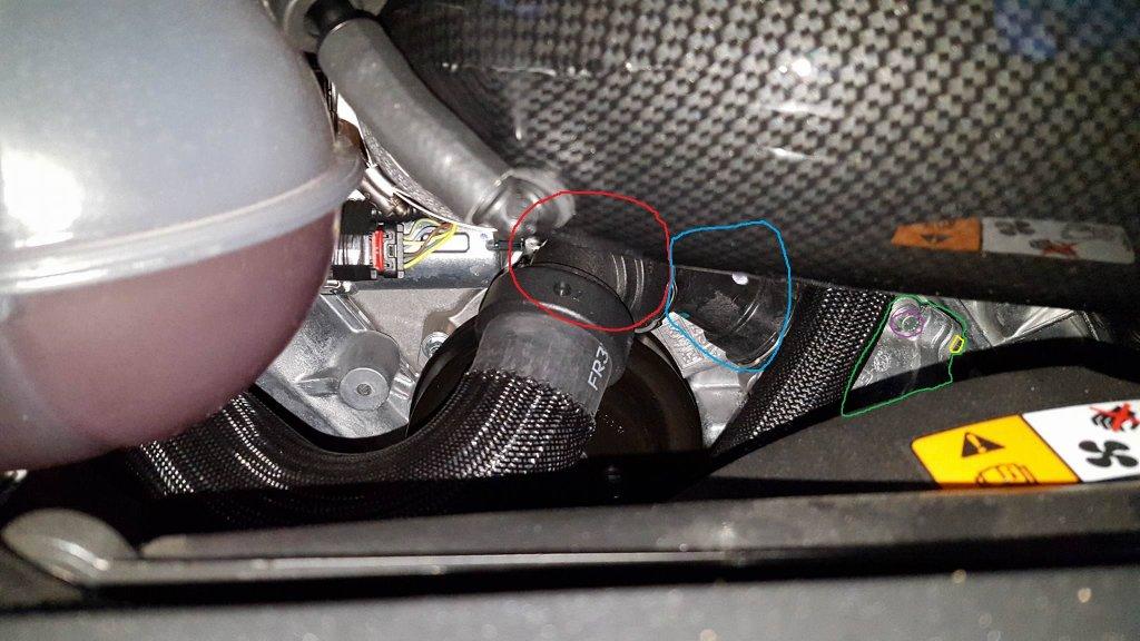

So pointed end basically goes to the left (if you're standing in front of the car). Sorry, I have a RHD, steering wheel and passenger seats are opposite lol.
Now I've just gotta figure out exactly where the thermostat comes out of. Someone here kindly circled it for me in a photo a few weeks back, I'll chase it up.
I'm assuming its above the bottom hose that's below that green circle and it's either the purple circle or the yellow circle nut (within the green circle).

It comes out wheir the green circle is,the purple circle is one of the nuts that hold the tstat housing on.
