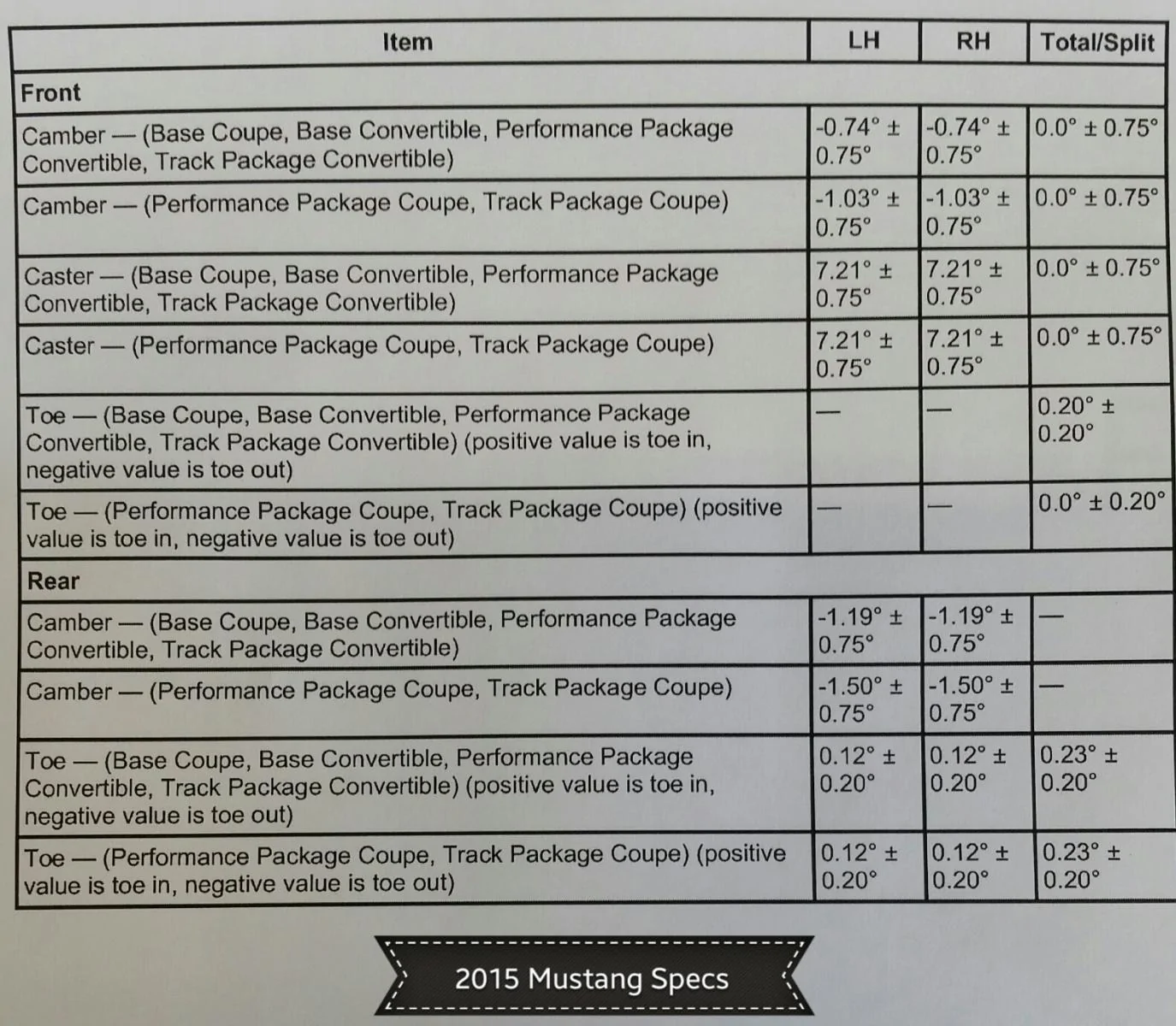

Thanks everyone.
Alignment wasn't to far off. Had to tweak rear camber and front/rear toe. Our machine doesn't have the 2015 yet, so I just used the 03 Cobra and printed out the specs.
My camber is 1.5° all the way around now and set toe to the stock specs. Once camber plates become available for the front, I am going to install them and realign. Little to much camber for me up front. I have the camber bolts, but not a big fan of them. But I may install them if nothing shows up soon. As you can see, the performance pack cars have a more aggressive alignment spec from the factory.
