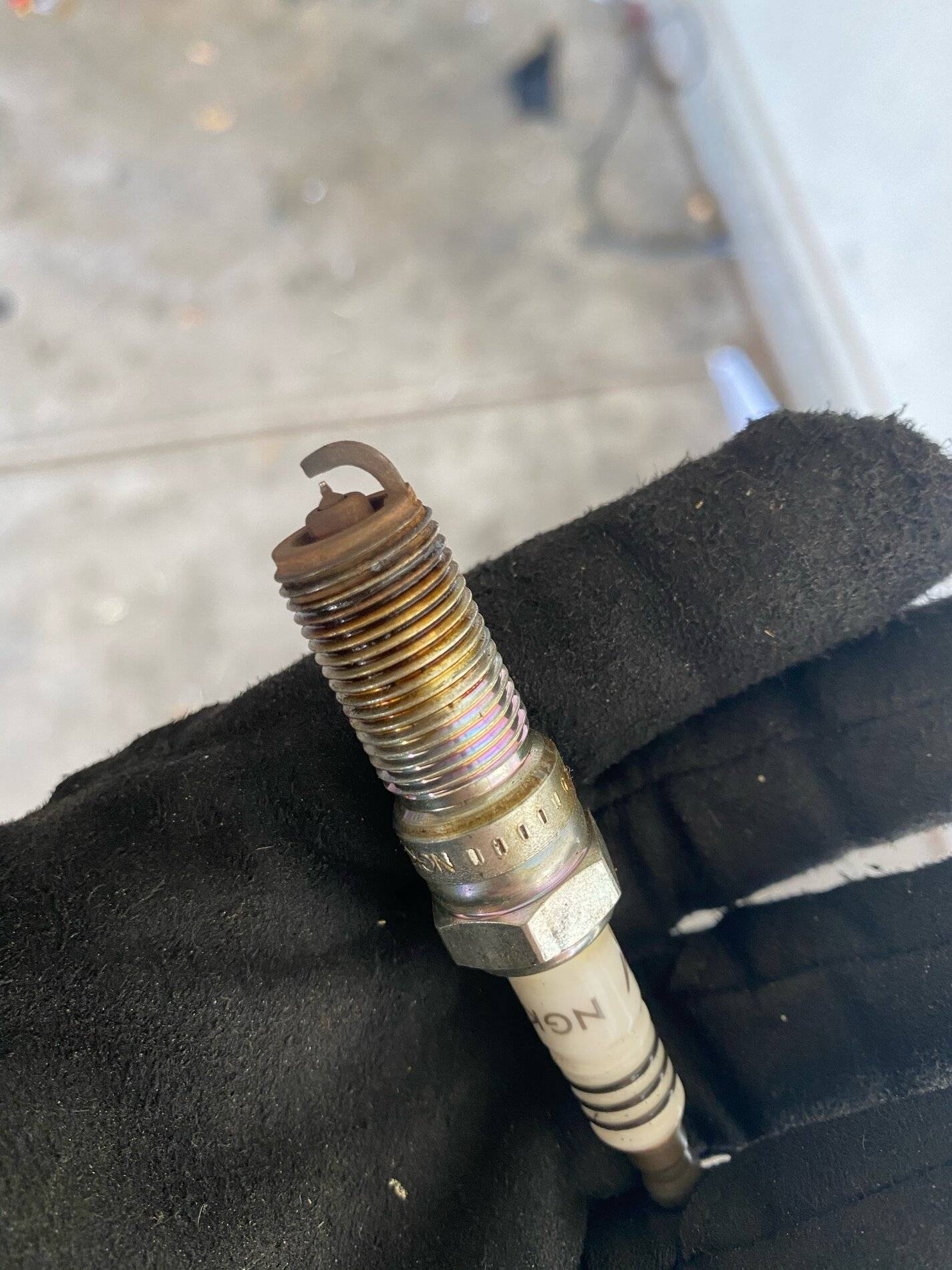

Alright well somewhat productive, I logged the car yesterday night, sent it over and was provided another tune, car didnt have a weak cold start which was good. Was advised to do a pull and i did two, they both came back with Knock sensors not liking that. Was advised to take out plugs, Which was done but wont be able to relog until I install tomorrow. crossing fingers yet again

What’s your spark plug gap? They may think you have spark blow out from too large a gap.

Okay guys, update is now available.. I waited like a real patient guy since oreilly and autozone wanted to tax like crazy on their NGK's for almost 100.00 so i ordered online for 56.04 and waited. I logged yesterday and no more knock, no more lean, and was given the green light to let it rip.. andgot a dub vs a c6 GS on ESS blower (:
