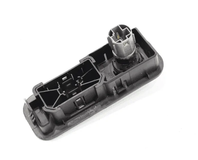

If you take off your center console, you can take the 12v charging plug from the hand rest compartment, disconnect it, push in the pin to pull out the power wire, twist it together with the power wire you’re adding, and click it back in, then plug it back into its original spot, and now you have 12v power when accessory mode is on or the car is on. It turns off after x amount of time. The ground wire, just run to another ground source, or try doing the same thing you did with the power wire. I used it for my active exhaust, works great. I wrapped it in electrical tape too just in case.
I like this location because I need switched power to the rear anyway.
Do I need to remove the entire center console piece to gain access underneath?
The panel pulls out. The wires, are pretty short though. Use a trim removal tool. You can see the retaining tabs in the picture. One on each end and above and below near the power port:
You’ll need to remove the whole center console to get to the power source, but if you need to pop off that plate, a flat head worked for me, but be careful not to snap it.
