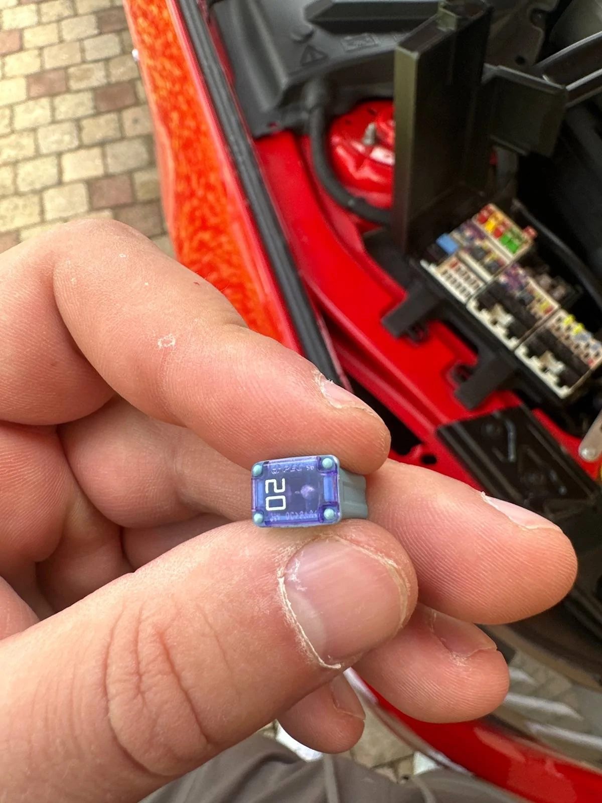

Dear members. Mine 2016 GT has an sigarette 12v output underneath the armrest. I want to use this power output for my exhaustvalve. I came to a fast conclusion this 12v won’t work… Ive checked the fuses already for the 12v sigarette but is all okay.
anyone knows whats up?

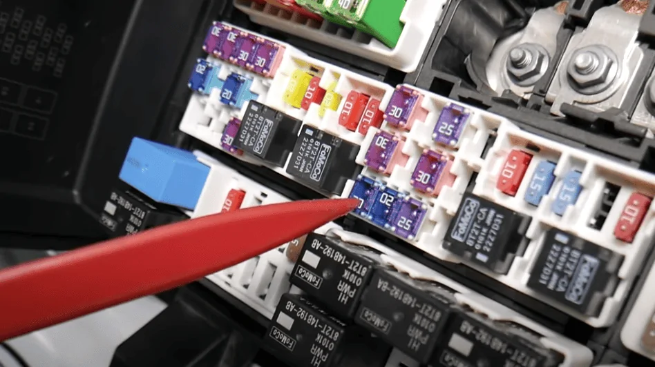

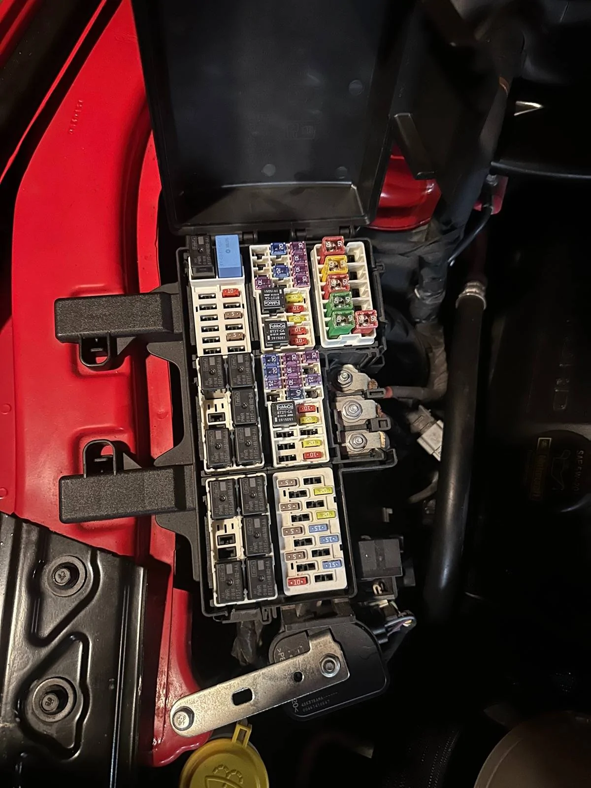

You should use engine bay fuse #34.

What are you trying to show us? Yes, it's a fuse. Does it test OK? Not a visual but with a meter. Is there power in the fuse socket on either/any leg?

The fuse was broken. Socket has power. So need to buy new ones. Here in the EU these are €7 which is 8/9dollars for 1 fuse… Crazy.. Where can u order them cheaper?
