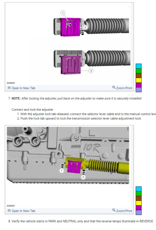

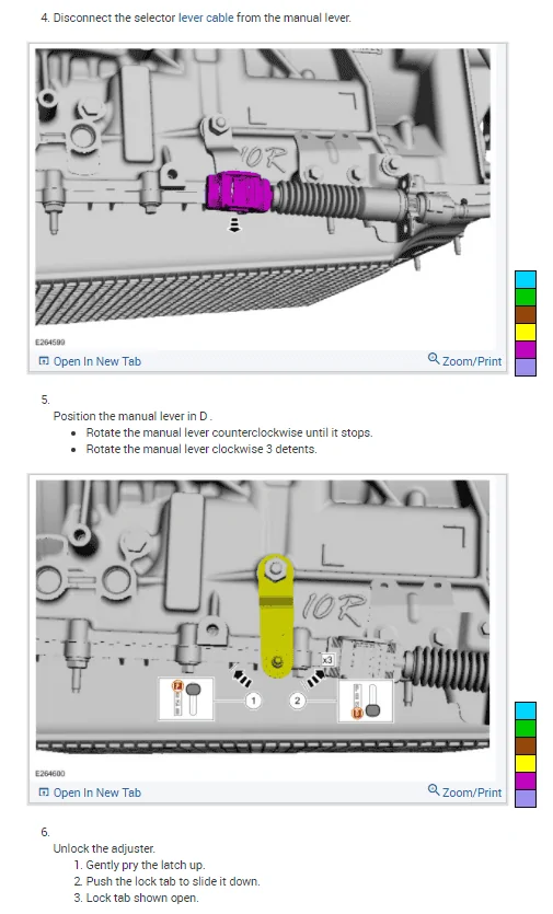

Sounds like an inspection of the cable connection on the trans is in order.
Det_Riot
Jul 29, 2018
463
353
Royal Oak, MI
Bryan
1994 Mustang GT, 2018 Mustang GT
Above in Step 5, you want to follow the pictures and not the instructions. Rotate the selecter CLOCKWISE until it stops (that will be park). Then rotate the lever COUNTER Clockwise 3 detents and that will be drive
